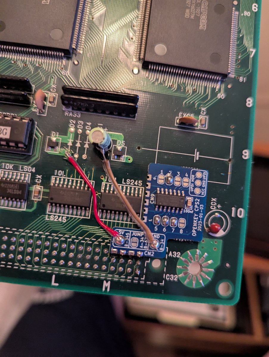

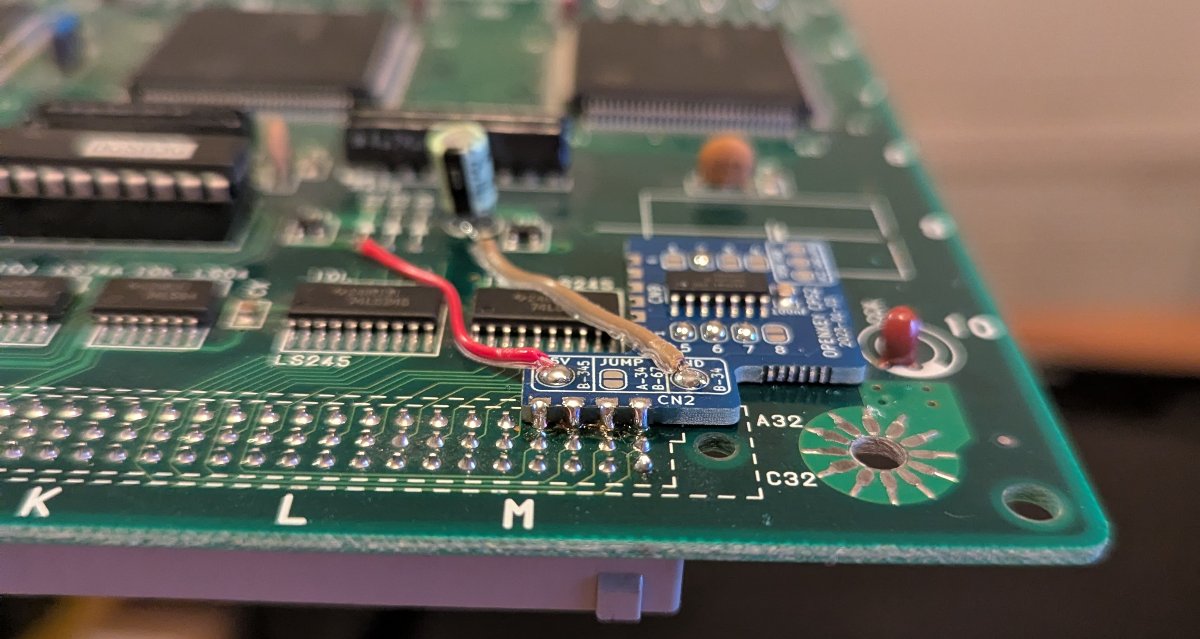

Hey all,
Working on resurrecting this marvel vs street fighter board.
A board is working, confirmed with my CPS2 multi
B board also working via a set of phoenixed X-Men COTA roms.
Wanted to put this back to stock, so I installed an Openkey
Buuuuut I'm just getting solid color on boot
Board specs-
Model 93646B-3
F PAL
Openkey installed on CN2
No resistor present like mentioned in the openkey docs
Confirmed all solder joints with a meter on my install
Jumped pads 2,5,6,&7
Any ideas what I need to look at?
When I got this the battery was dead so I can't confirm it's a JP region ROM set, but the case was green so that's what I went with for the jumpers.
Thanks!
