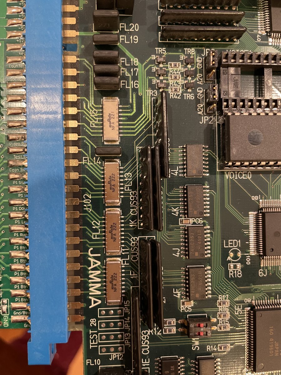

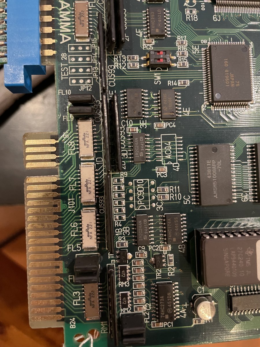

I looked at them with my magnifiers on and am not positive which are good and which are bad. Not sure if these pics are good enough, but would appreciate another set of eyes before i dive in.

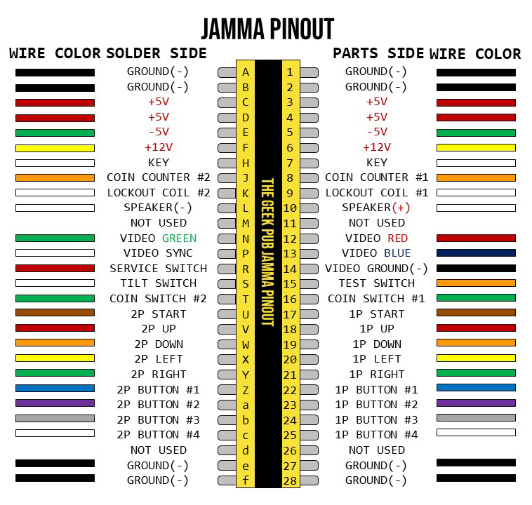

You'll want to trace the circuit for your malfunctioning control input. In this case, Player 1 Down is Pin 19 of the JAMMA connector on the Parts (Top) side of the board.
It's also conveniently labeled on the connector you have plugged into your board currently in your first picture.
You can see the circuit come out of the P1 Down pad on the JAMMA connector into the last pin on the FL12 filter. I recommend you take a multimeter, set it to Resistance (the Ohms symbol) and touch one probe to that JAMMA pin on FL12 and one probe on the other side of the filter opposite it. Do this with the board powered down.
If the meter reads the same as when the probes aren't touching anything, then there is no connection between the points on the circuit and you know that filter part is bad. If the meter does read a connection through the filter then the problem is further up in the circuit, past that filter. Your meter should read a connection on both corresponding sides of the filter on the other pins of the part since your other control inputs are working.
I don't see any obvious cracks in your filters like there was with mine, so your problem might be elsewhere - do the multimeter test to find out. How does the bottom side of the board look around the same area as your first pic?

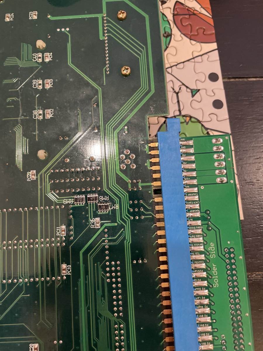

And here’sa pic of the bottom of the board

No sign of damage on the underside of the board, so that’s good. And the video you sent me of probing the inputs showed that you diagnosed it correctly - the FL12 filter is passing through the other inputs but not the P1 Down.
You should be able to swap out the FL12 filter with the one from FL3 to fix it. Outfoxies doesn’t support 4 players and FL3 is only used for 4 players so you won’t lose any functionality.
