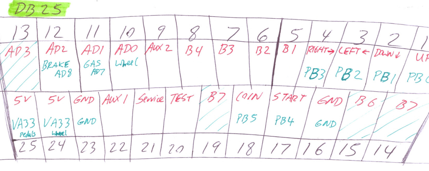

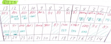

6.) Follow this wiring diagram to hook everything up.
Wiring Diagram:
Couple of notes about the wiring diagram...
- You can run multiple wires from one DB25 point. You will need to do this to run AUX1 and AUX2 to the buttons and to the Gear Shift.
- There are only two GND points on the DB25 connector, but you will need to run 3 ground wires. One will need to have two ground wires running off it.
- I may have drawn the 8-Pin Connector Pinout upside down. If the buttons don't work, try the reverse order.
- You can wire the A/B/WHITE/X/Y/BLACK buttons up however you like. You don't have to follow my diagram.
- I wired the shoulder buttons (those two green hand clickers) on the wheel to Service and Test buttons. If you accidentally keep going into the service menu, you may want to leave those unhooked up.
- There is a tiny button on the dash board. I didn't hook this up, but it's likely the VB1 spot on the 11-pin connector.

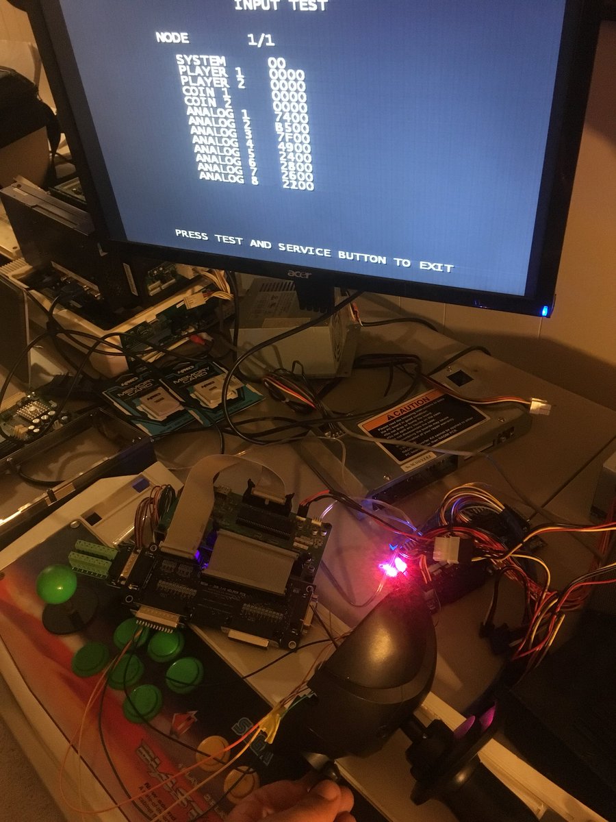

Between your post, and S-JIHP: Sega JVS I/O Helper PCB - Live at Retro Barcelona. I was able to get a cheap aircraft joystick working with MonkeyBall. It also worked as a means to quickly prepare for the driving wheel I have on the way. I was able to drive Crazy Taxi with my joystick albeit awkwardly.
I went to my local Microcenter and picked up a Thrustmaster USB Joystick today with the hope of getting a proof of concept working ahead of my wheel arrival.
For $20 this seems to work fine for my purposes. http://www.microcenter.com/product/404812/usb_joystick
I wanted a poormans banana!
I simply cut out the control board, took note of the PCB markings and wired it up accordingly. The only ones I had to guess at were the buttons on the top of the stick for firing, and other options. They were not labeled in anyway. It is worth noting they shared the same common ground that was labeled with a "-" on the PCB.

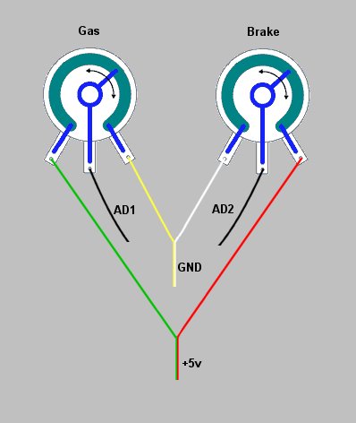

The Dreamcast Racing Controller HKT-7400. Not the greatest racing controller, but if you're on budget and like to keep things compact then its perfect.
Perhaps the easiest controller mod i've ever done. Just remove the bottom panel, all the wires for all buttons and pots are accessible.
Just cut the two wire harnesses from its pcb. The 3-pin is the Steering wheel while the 9-pin has the left & right paddles and buttons. After tying the grounds together and +5V together, you'll have 10 wires going to your DB25 connector. I hacked off a cable from a broken Sony PS1 controller because it has exactly 10 wires. I posted a pinout down below.
The other necessary modification was to swap the Red and Black wires on the steering wheel pot, or else you'll be stuck with inverted steering.
Every racing game has a different button layout, so I decided to wire the 4 digital inputs (+),(-), A, B from the dreamcast controller to Sw4 thru Sw7 on the I/O Helper pcb. Afaik these switches are never used by any racing game that i know of on the Naomi, Chihiro, or Lindbergh. So for every game i have to jumper pins around on the I/O helper pcb. Here's the pinout i used from the Dreamcast controller to the DB25.
