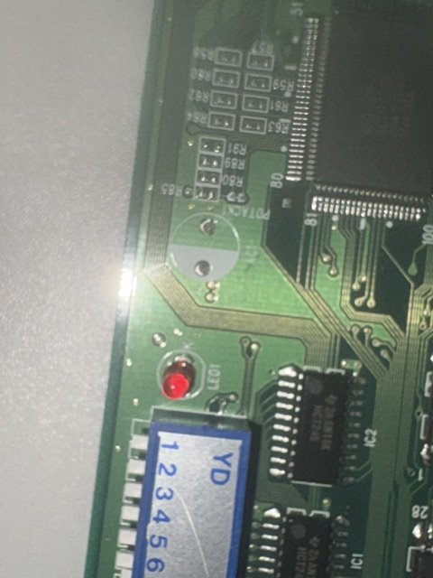

A Abou83 Beginner Joined Jan 23, 2026 Messages 4 Reaction score 3 Location France Jul 11, 2026 #1 Hello guys I need some help for my KOF pcb, one cap is missing in AC1 in left side, someone knows the cap value please

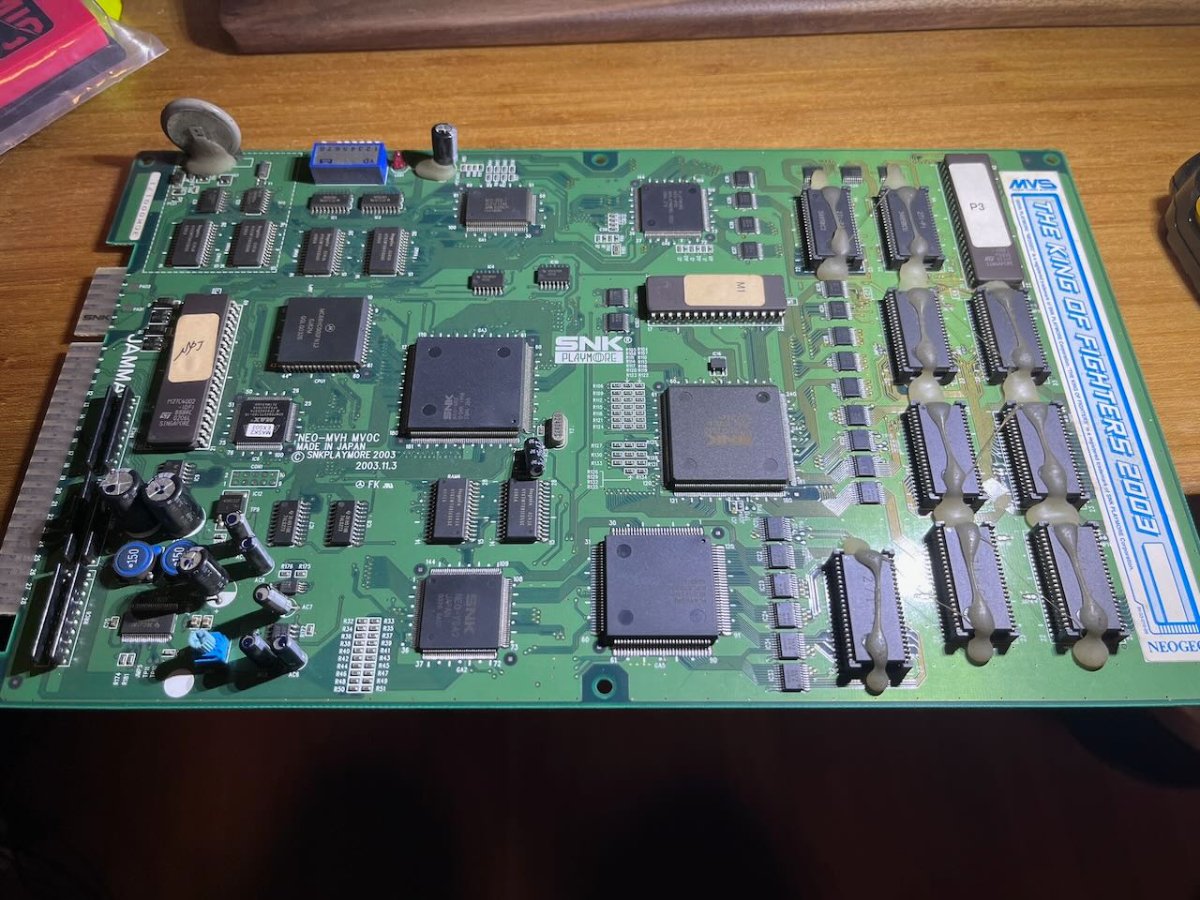

Kujako Champion Joined Jun 3, 2020 Messages 1,562 Reaction score 990 Location USA, California Jul 11, 2026 #2 To be clear, this is one of the single board versions and not a MVS cartridge? I think I have one around here someplace, let me check...

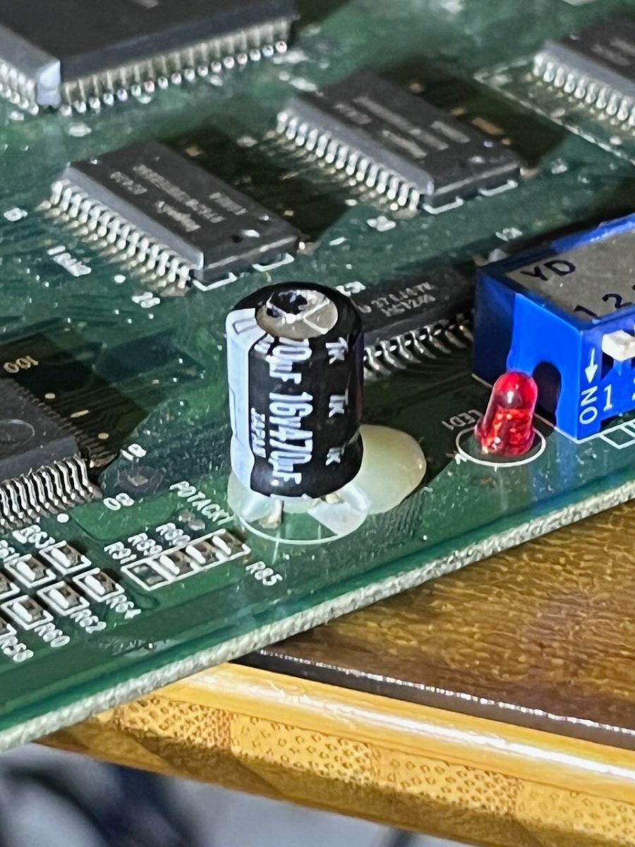

Kujako Champion Joined Jun 3, 2020 Messages 1,562 Reaction score 990 Location USA, California Jul 11, 2026 #3 Found mine, looks to be 16v 470uF.
A Abou83 Beginner Joined Jan 23, 2026 Messages 4 Reaction score 3 Location France Jul 11, 2026 #4 Ok thanks u confirm my doubt
Kujako Champion Joined Jun 3, 2020 Messages 1,562 Reaction score 990 Location USA, California Jul 11, 2026 #5 Abou83 said: Ok thanks u confirm my doubt Click to expand... Best of luck with the repairs.
A Abou83 Beginner Joined Jan 23, 2026 Messages 4 Reaction score 3 Location France Jul 11, 2026 #6 Thanks i installed a new cap it’s ok
