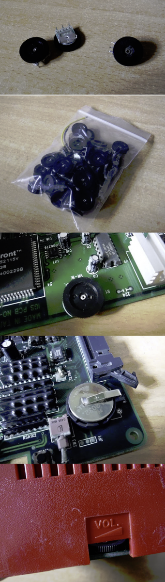

1k P104 pot works fine. you can ghetto style it, extend the wires or do it more proper.

Finally got my minigun supergun up and running. My IGS PGM isn't outputting sound though even after a recap. I am guessing it's this wheel? Is this a normal problem on the PGM's ?
Still not getting sound out of my igs. I tested a volume pot that was linked above by GCtech but to no avail.

I found these radial dial pots as a close replacement. They aren't 100% pin compatible - you have to solder a wire link underneath, but they work well:
If you're not getting any audio try shorting the pins with a wet finger around that pot area. If you don't get anything, not even a hum then your audio amp or 12v in is bad.
