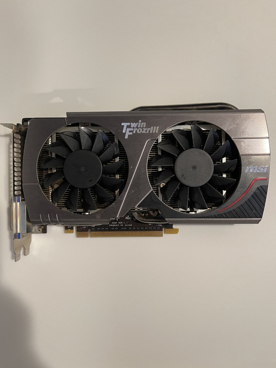

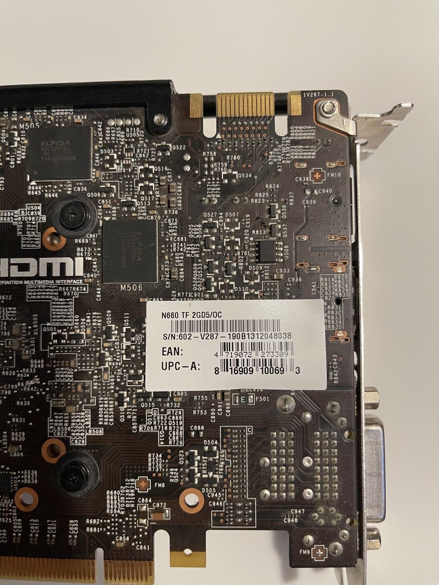

@Murray I need help. The dip switches on my X3 will not change the resolution, and none of the games will load. I have a i7-2600k, 8gb, & 660.
Are you using the exact stock 600gtx video card that comes with the TTX3 units?
Also it's either dip 1 or dip 2, i can't recall exactly which one off the top of my head, it's one of those though.
I thought it was an official card but its acting like the drivers are not working and kicking me back to the menu.
I tried to update the bios on the card with the official bios file posted on AP but now the card outputs distorted garbage.
