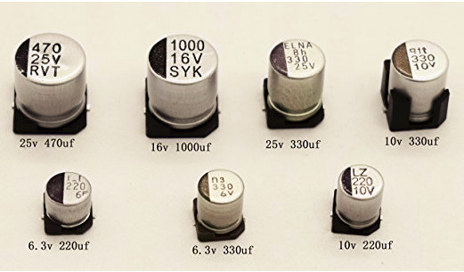

I guess he meant electolytic capacitors.If this is the case, he can easily solder thru-hole ones to my repro instead of SMD.But if he meant the ceramic capacitors, there is no way to do a DIP version :) There are more than 10 ceramic capacitors , where the hell I should find room for thru-hole ones???I should design a module bigger the the arcade PCB itself in order to accomodate them :D I chose '0805' package for ceramic capacitors and still I had trouble to find room for them and I chose this package just to make soldering job easier otherwise I would have opted for '0603'.
Lastly, I don't think electrolytic SMD capacitors are really hard to solder, they are big enough :
True. You don't NEED hot air or solder paste to solder down smd caps. You can place solder on one pad, heat the solder while laying down the cap, then solder the other pad. I think also a lot of people tend to think that through-hole caps last longer and are more reliable but there really isn't any evidence to support that. It's just a different package.
