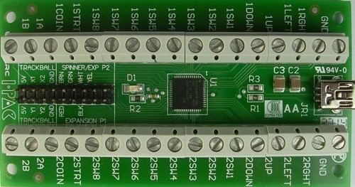

In case anyone cares I was able to easily interface my AstroCity control panel with my MiSTer with this USB encoder.
Nice, didn’t know they made a 2 player version. Does that show up as one game controller or two? Wondering if it has the issues of swapping player 1 and 2 sometimes.
I've never used that device... but no, it won't be affected by the swapping issue.
That only occurs when using two single player USB devices, because unlike with networking...
Windows can't hold a USB device assignment for a specific ID (like a router can hold a IP address for a specific MAC address).
Its purely first request, first assignment (aka basically random).
