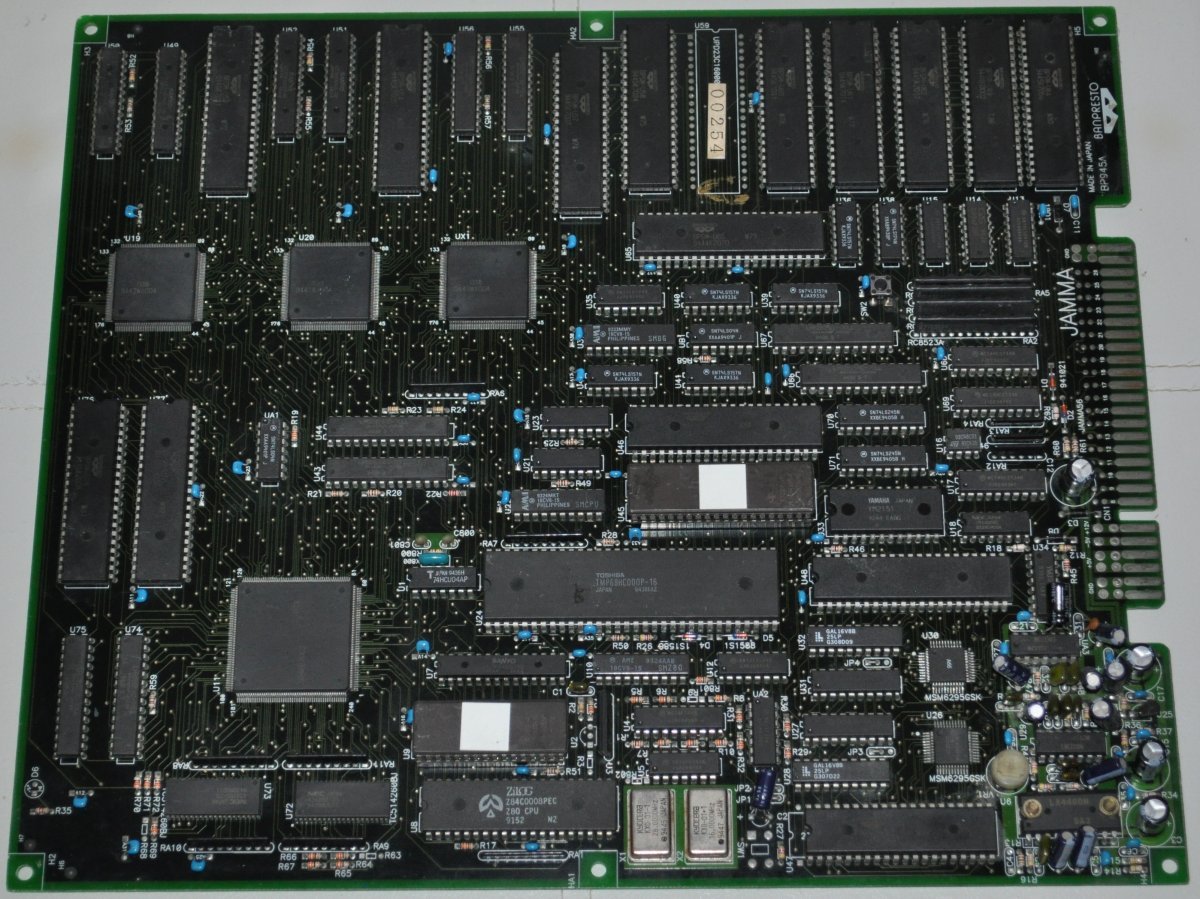

Checking mame, it seems these 3 titles share the same hardware. I have a Sailor moon, and looking at the Air Gallet pcb they look like they are both identical and it could be as simple as a rom swap to convert these. Need to look at the Metamoqester pcb to see if its the same, most likely it is.
Any of our resident experts have time to take a look to verify if its doable? Maybe make a 3 in 1 setup for these boards?

Metamoqester is quite different from the other two
2 in 1 multi :D I would be happy enough if I can switch between Air Gallet & Sailor Moon.
Metamoqester seems to have a different layout/arrangement, but the same major components, so there might still be a possibility that it can me made to run on the other titles/vice-versa?!

It looks like Metamoqester has a lot more ROMs (both mask and EPROM) than the Air Gallet, quite a bit more RAM too.
I came to the same conclusion about a possible 3-in-1 looking at the driver a while back.
I know of someone that had converted an Air Gallet to Salor Moon, so that is definitely possible.
