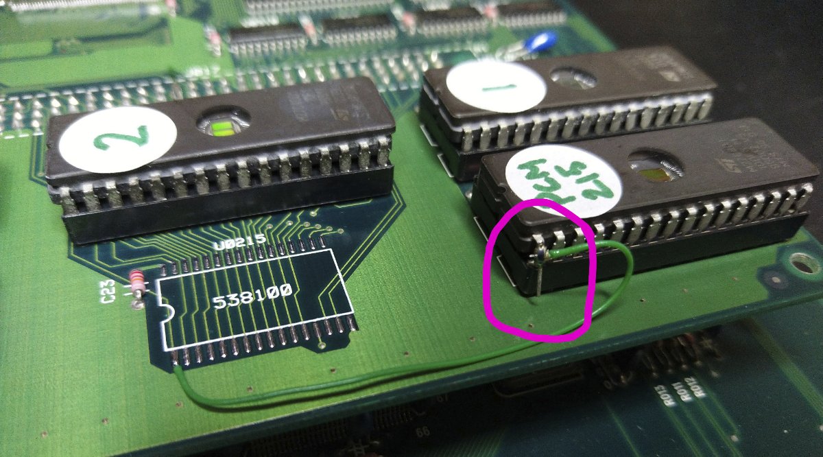

@everten Sorry, I was typing from memory and perhaps wasn't as clear as I should have been. The flat tiny pins bit was my very crappy attempt at describing the pair of flash chips on the motherboard.
You are correct regarding the 2.0 version board, it's the same as mine. If you look closely you'll see there's a trace to the flash chips.
