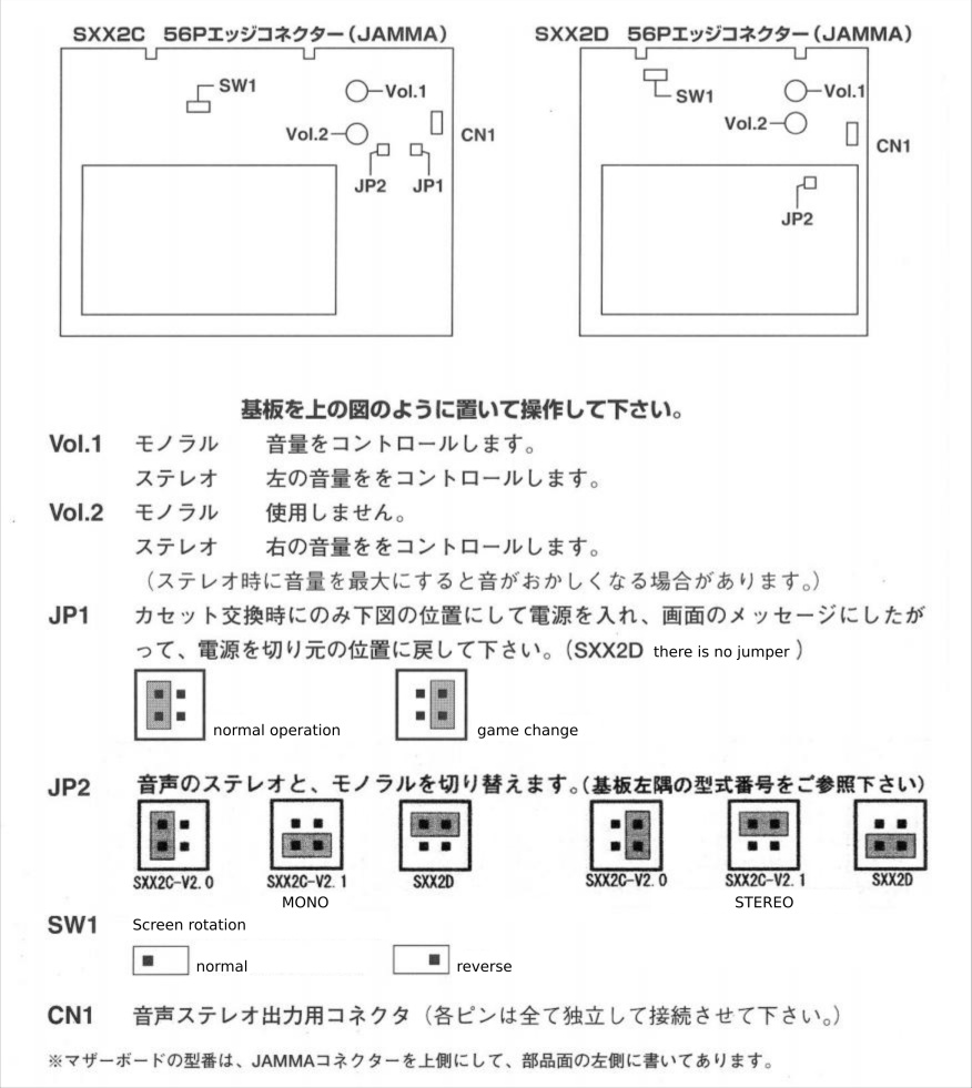

There's also mistake in the Mame documentation. For the smaller board SXX2D, there is no jumper for game change. You just swap in a different game and let it flash. The jumper (JP121) is for mono / stereo switching. I attached a scan of the japanese manual taken from @yosais blog (link) and translated the key points.
