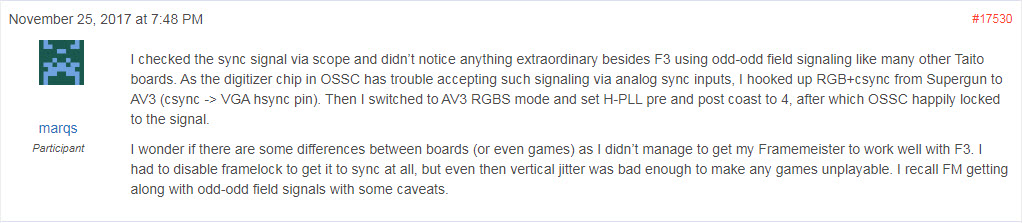

Marqs solution to get the F3 working on the OSSC is this as far a sync goes, but I guess you guys already know this?!
But a circuit that fixes the sync and horizontal shift/position issues on the F3 would be ideal.

He is feeding Csync on pin#13 (H-Sync) of the VGA head and leaving pin#14 (V-Sync) unconnected.
I'm interested in using a Sync processor/regen to feed a separated H-Sync and V-Sync to both pins13 and 14 (aka the correct VGA wiring only the wrong 15khz not 31khz rate).
