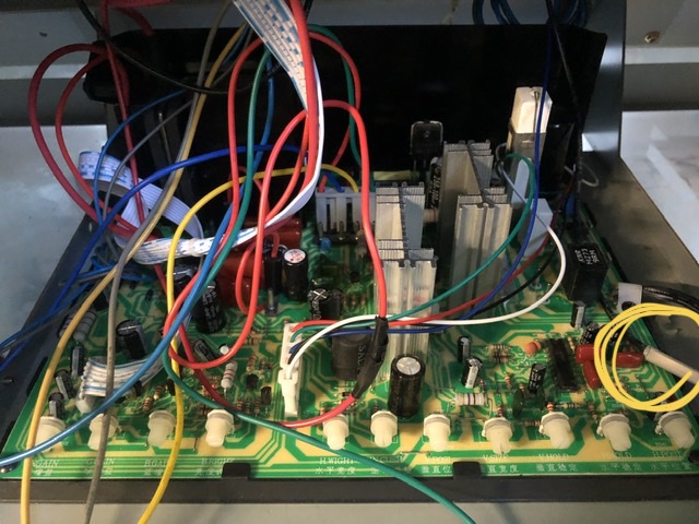

rewrite Multi Boyz Litigator Immortal Multi Boyz Joined Nov 9, 2015 Messages 8,166 Reaction score 7,766 Location SoCal May 26, 2020 #21 Can you show me which you're talking about?
Report2Marty Student Joined Nov 24, 2016 Messages 95 Reaction score 28 Location Cincinnati, OH USA May 26, 2020 #22 Sure! Marked with yellow circle! Attachments FE6D2DF1-9C4B-49D3-A53A-352F3A37F25C.jpeg 127.4 KB · Views: 96
Report2Marty Student Joined Nov 24, 2016 Messages 95 Reaction score 28 Location Cincinnati, OH USA May 26, 2020 #23 I went ahead and tied the two return ground wires together and connected that to the neck board..... made it worse... lol.
rewrite Multi Boyz Litigator Immortal Multi Boyz Joined Nov 9, 2015 Messages 8,166 Reaction score 7,766 Location SoCal May 26, 2020 #24 Well you've got me. I vote test the PSU out of the casing and see if everything still shocks or not at least.
Report2Marty Student Joined Nov 24, 2016 Messages 95 Reaction score 28 Location Cincinnati, OH USA May 26, 2020 #25 Also, there’s a spot on the wei ya with two prongs and DGC printed next to it. That’s the connection for the degauss coil, right?
rewrite Multi Boyz Litigator Immortal Multi Boyz Joined Nov 9, 2015 Messages 8,166 Reaction score 7,766 Location SoCal May 26, 2020 #26 I'd have to assume yes. We're working with different chassis here.
