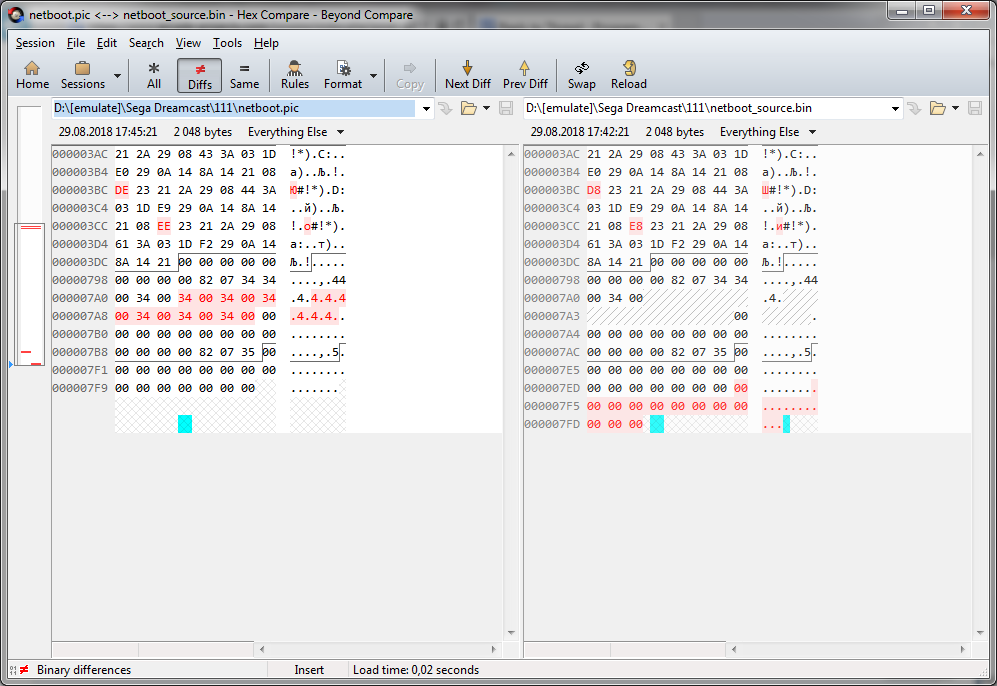

how do you then explain difference between genuine and 100% working Sega PIC (left side), and yours one (right side) ? why it doesn't match original dump ?
as I see there was removed some bytes from data section, and data section in general was moved, why you did this ?

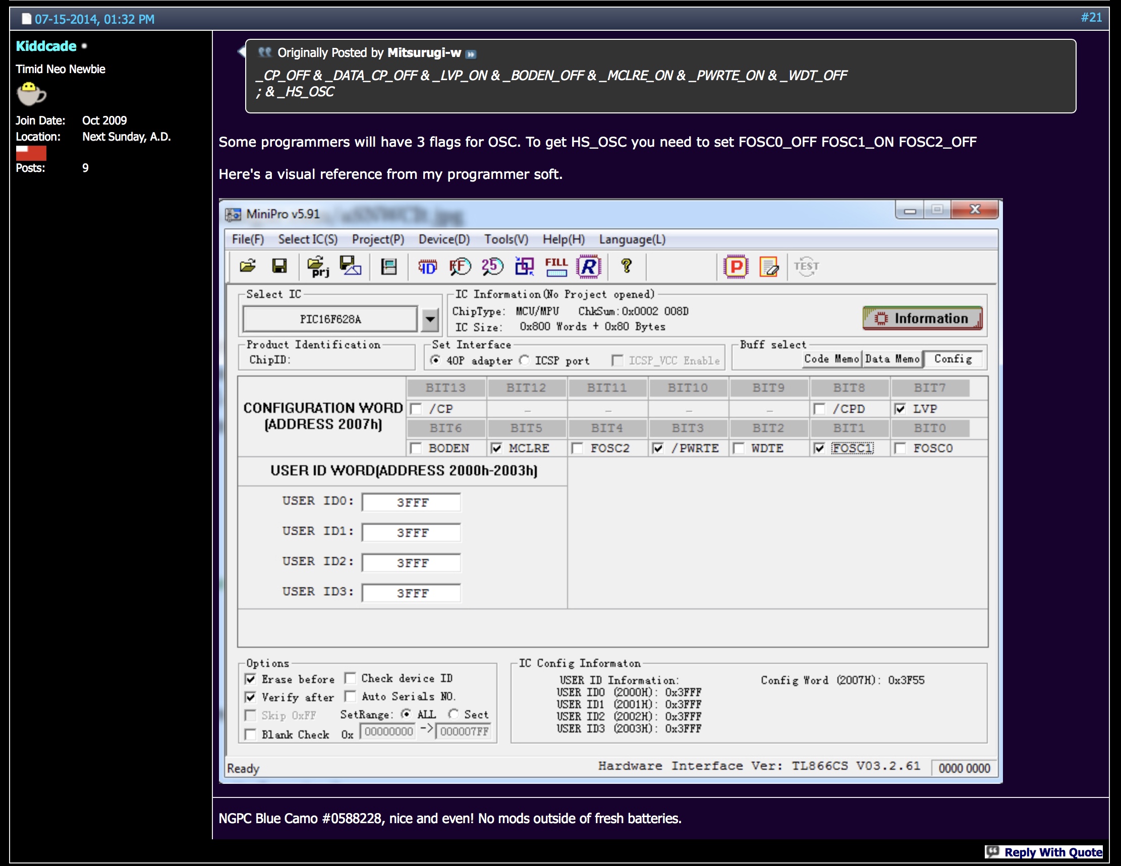

So did @Mitsurugi-w with fuse settings...
@leonk dropped some more info as well... including an alternate pastebin vs the one most folks were using at https://pastebin.com/jyELVuUt

yes, there is the code. but the code did not explains why you did changes so it doesn't match original Sega code/data. and that's why I'm asking for explanations.
there is no sega code that we have. you keep claiming this and its just not true.
