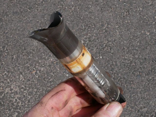

PSA: MS293X, faulty chassis can break the tube
Possible that the crack happened later too. Like when it sat in the warehouse or when my buddy pulled the yoke. The arcing was inside the neck and puff of smoke came right off a spark gap on the neck board.
Well, letting gas in is a pretty good way to cause HV arcing to places inside the tube, so I wouldn't be surprised if subtle physical damage was step 1. It could have been a small fissure that finally had enough.
I can assure you, my tube was crack free and I operated it for over three years just fine before I connected the Yaton chassis to it. Saw the spark near the yoke and now it has air inside.

Had no problems with this monitor before this. Then one day, no image, heard clicking from the chassis. Turned off the cab, was taking off the neckboard when I noticed there was movement in the neck. Ruh roh.

So it is the tube not the chassis that is causing the CRT to go to air?
The chassis is definitely involved. My Blast tube blew when the faulty Yaton chassis was attached to it.
