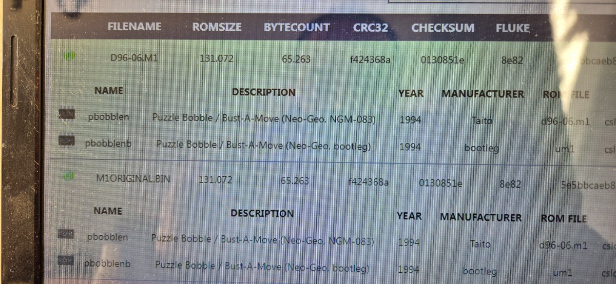

What the crc of your M1 ?

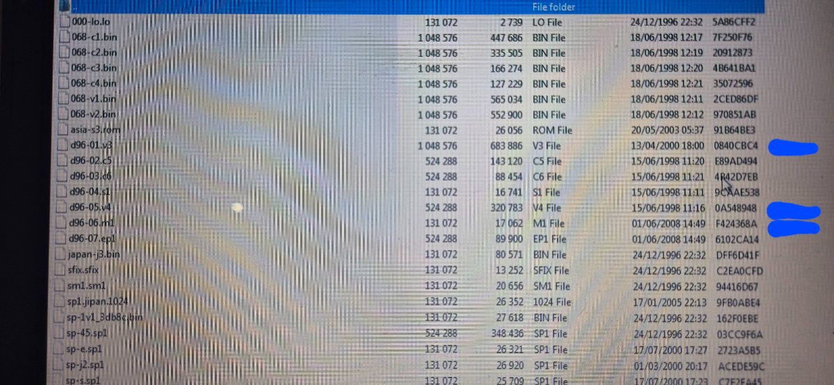

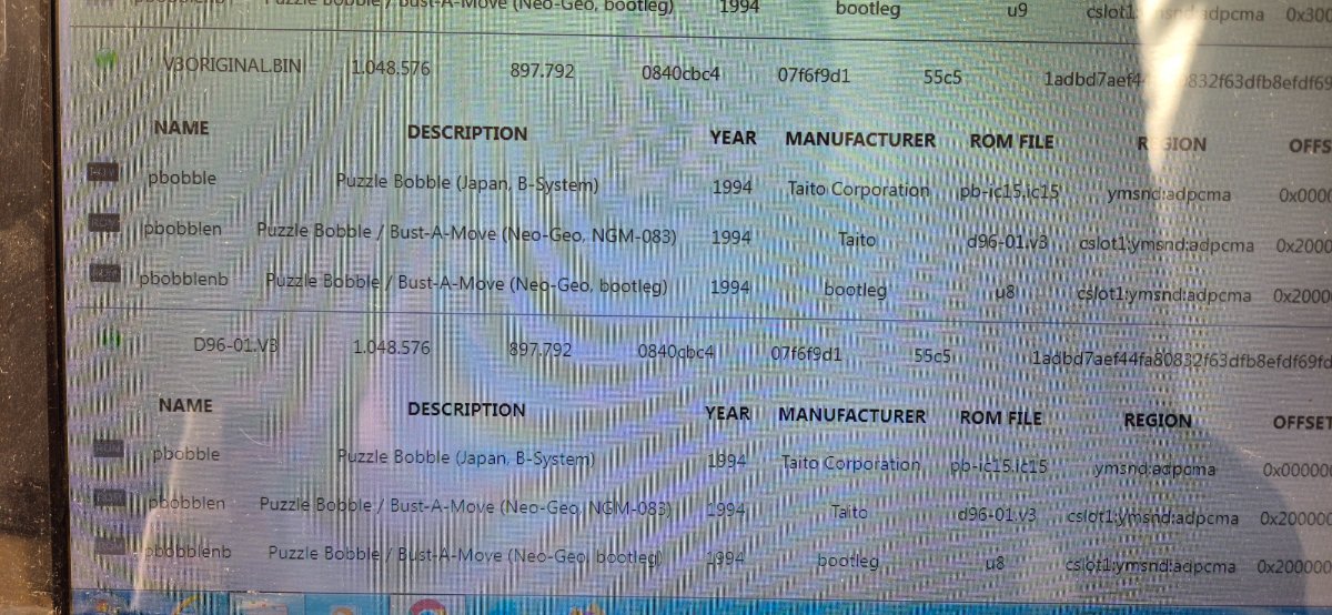

I have recheked in Arcadefraidi V3 and M1 and EP1, against original roms, and they are matching the CRC.

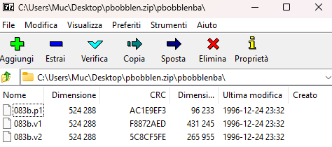

As you can see in comparison picture below, V1 EPROM on your bootleg needs to be populate with 1MB of data (on pbobblenba 083b.v1 + 083b.v2 = d96-01.v3 [pbobblenb] or u8 [pbobblenb]) and V2 EPROM with 512 KB of data (d96-05.v4 for pbobblen and u9 for pbobblenb [same data])

pbobblenba set is known as a bad dump of pbobblenb

Actually this is the set that i have used to write the V1, V2 and M eproms.
The CRCs are matching those you have mentionned.
