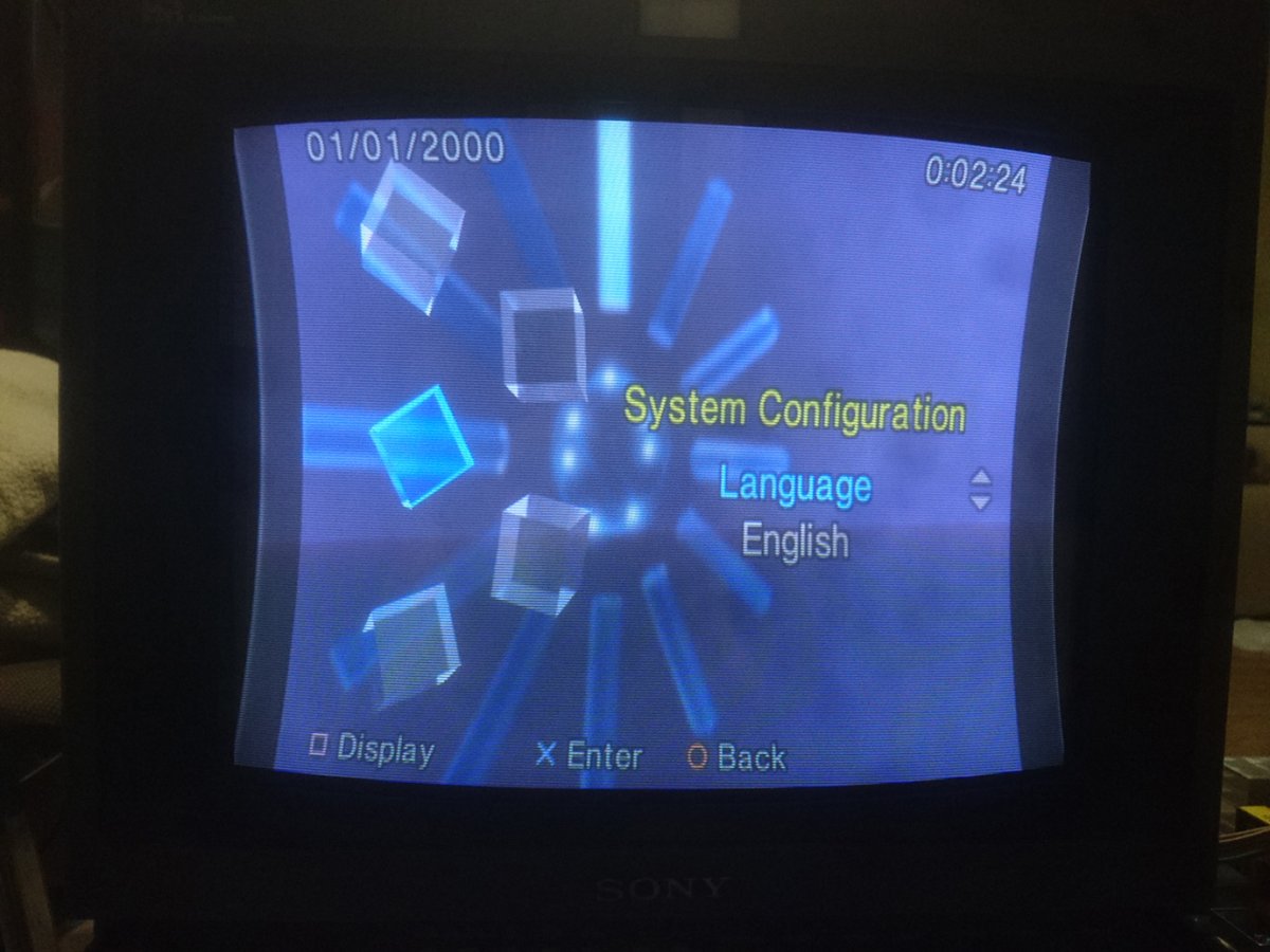

The problem with pincushion distortion still persists, at this point probably the only thing i can suspect is IC509.
Raster with L509 removed looks like this.
