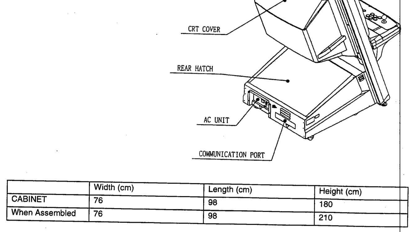

could anyone confirm which measurements these are? like front to back and side to side. idk which sides these refer to.
Width = side to side
Length = front to back

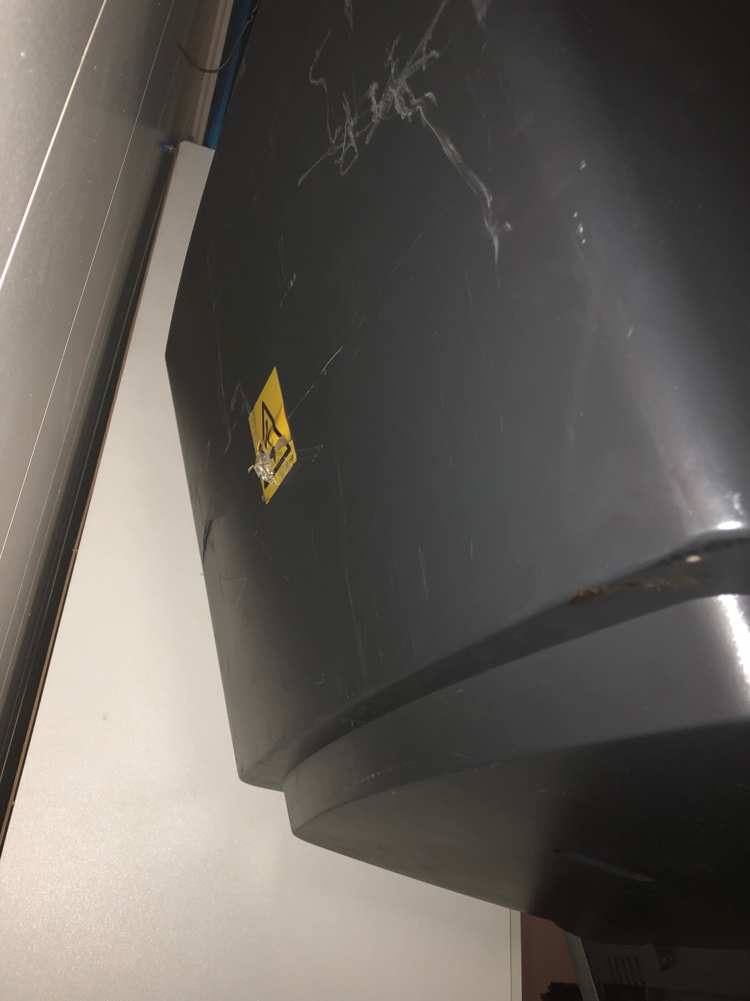

Very thick and sturdy construction, nothing will ever happen to that, the plastic is very heavy and very thick, a lot more than a dust cover ;)
Maybe I should send a picture of the big crack in mine? =]
