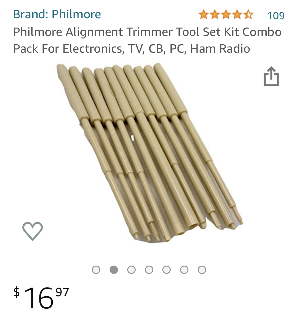

The focus will adjust the sharpness of the image/scan lines. Screen will adjust the brightness or darkness of the monitor. In my personal opinion I would make sure I had the proper tools for adjusting electronics such as an electronic adjustment plastic tool kit.
