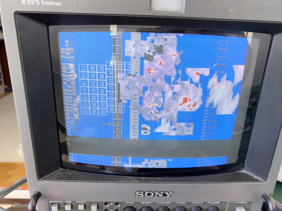

I bought faulty (must start somewhere right?) Raiden 2 pcb.

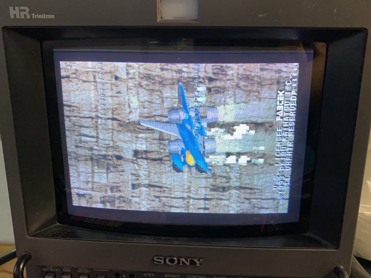

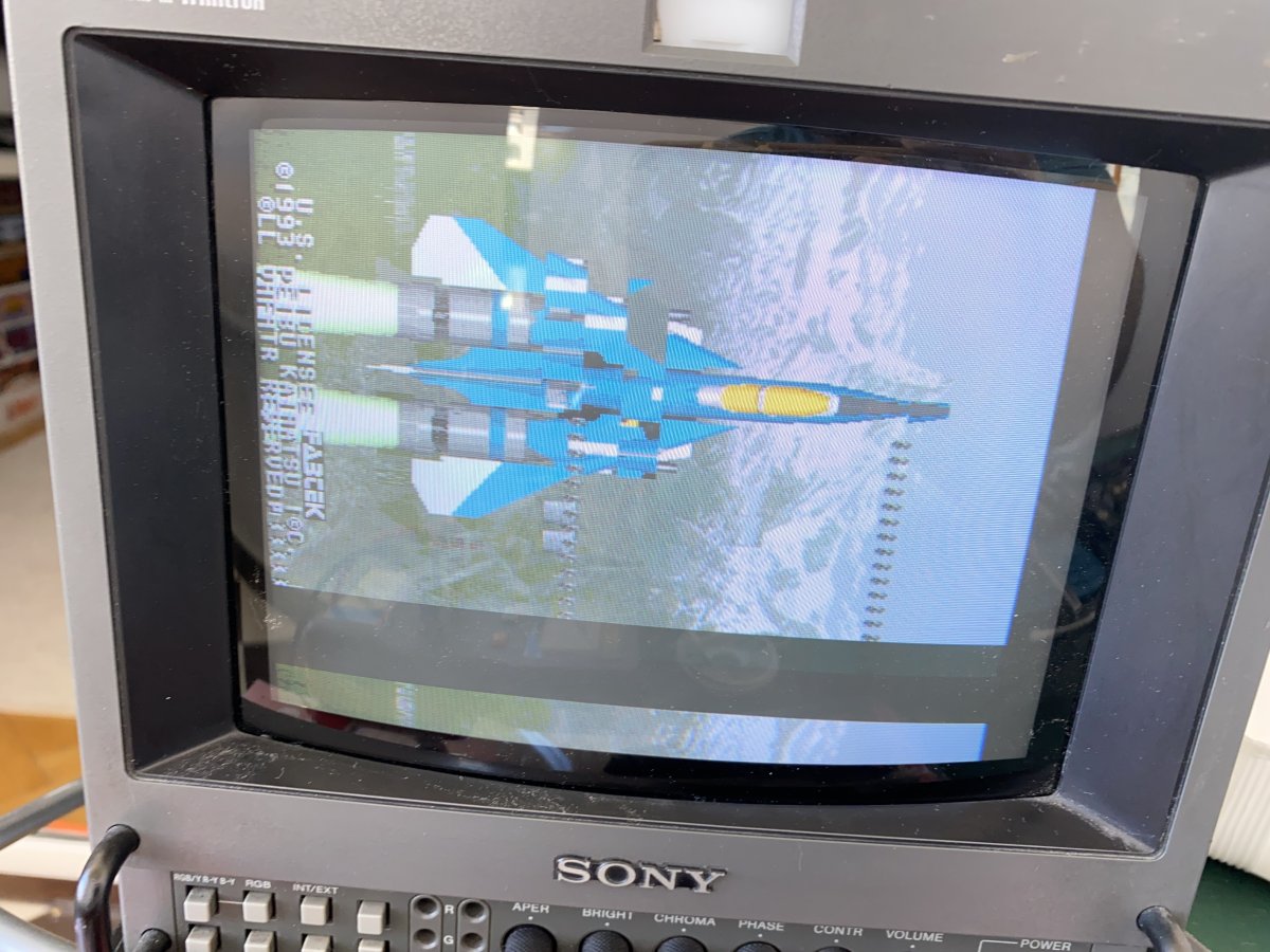

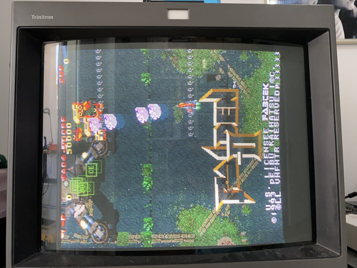

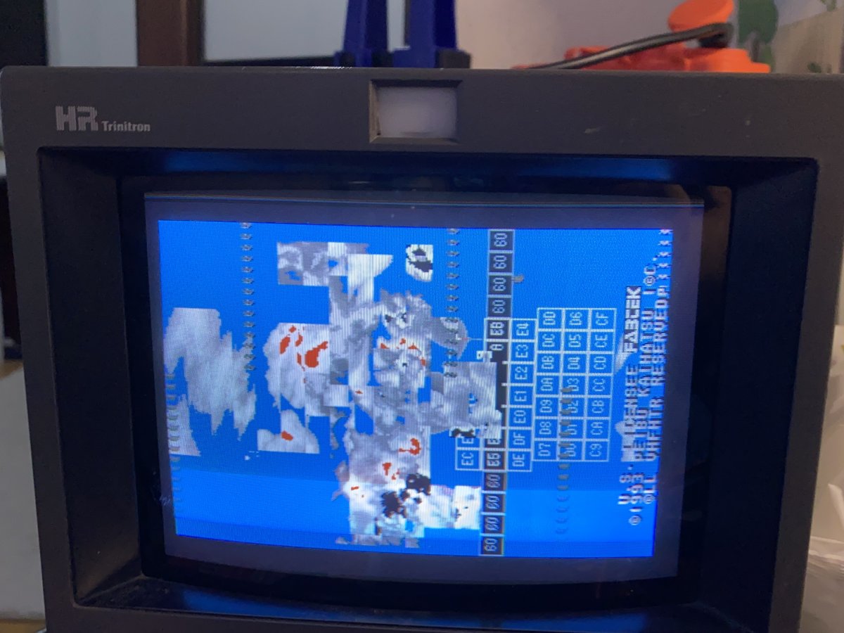

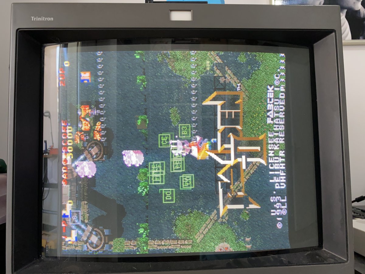

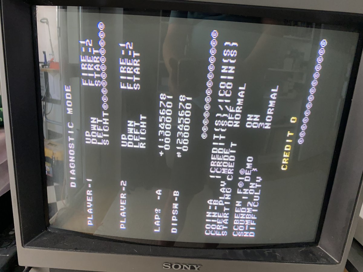

Problem : Graphics are distorted. Some numbers shown. Some text's are corrupted or wrong.
What is working : Game playable, coins up, starts, all controllers works well. Sound Good.
First; i was testing the system with my 9" Sony CRT PVM using supergun + SCART RGB (my test bench)
There was a sync issue. Then i tried with my play system (custom made supergun + 20" Sony crt PVM RGB)
And there was no sync issues. Only graphic problems.
Then i have found out that on my play test system 5V rail is 4.98V but my test bench 5V rail is 4.82V. When i adjust it to 5V sync issue resolved.
Okay so far what i have done listed; open to any suggestions.

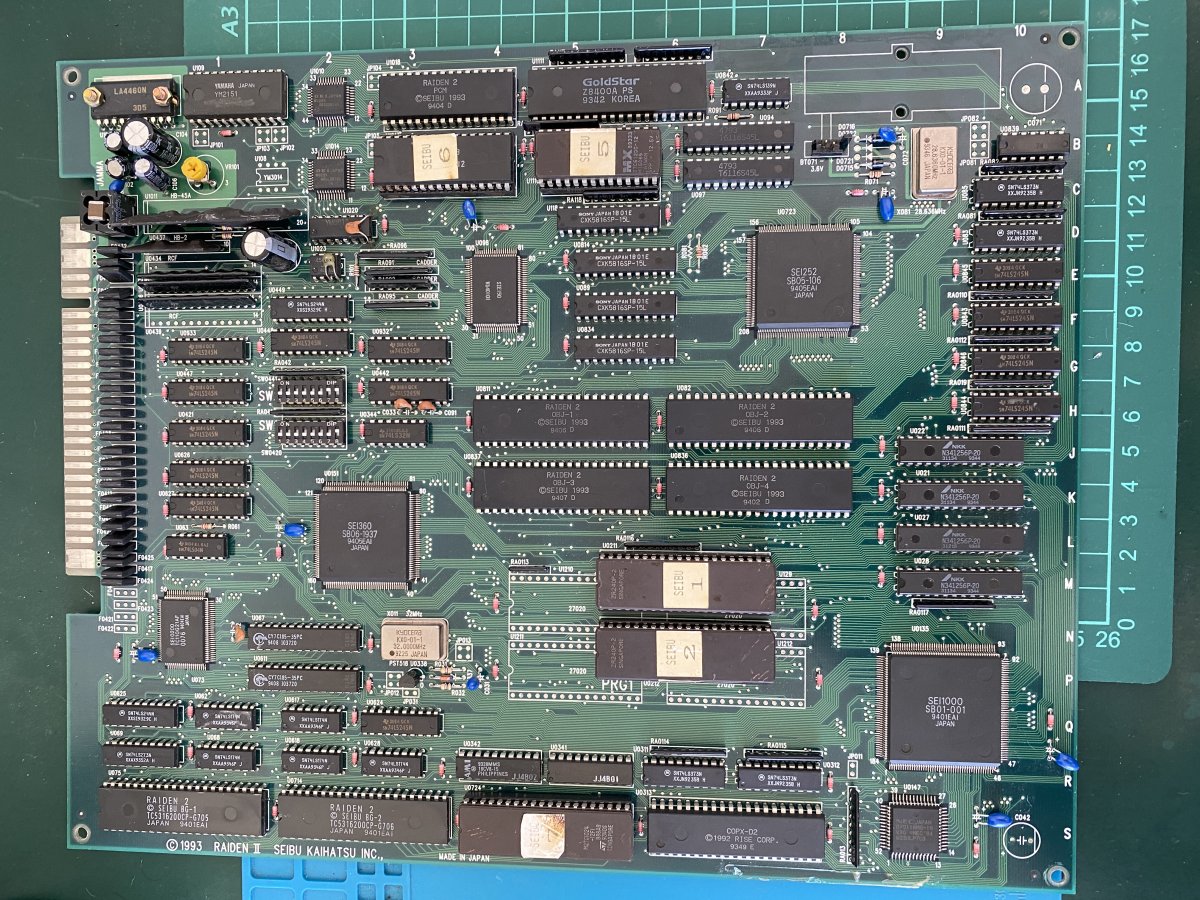

2-) I've applied force to the pins of SEI360, SEI252 and SEI1000 to see if any pins not connected. But all were ok.
3-) While system works i have applied force with my finger to all chips one by one. Nothing changed on screen.
4-) I've test every chip for 5V rail. All ok.
5-) I've piggybacked all 74LS245N chips. nothing changed (2 of them makes graphics worse, maybe my chips are bad)
6-) Checked all chips for any overheating. None detected.
7-) I thought maybe ram chips are broken. on U067 and U0611 (CY7C85-35PC). and piggybacked them with whatever i have (same pinout and same sizes sram) --> MT5C6408. nothing changed.
What can i do more?

Regarding reading rom 1/2. You can check the Raiden 2 Driver in Mame.
"Later boards
1 - 27C402 or 27C4096 EPROM labelled 'SEIBU 1' at location U0211 (DIP40)
2 - 27C402 or 27C4096 EPROM labelled 'SEIBU 2' at location U0212 (DIP40)"
Thanks @Pythagoras I was able to determine 1 and 2 roms. 27C4096 did the trick.
