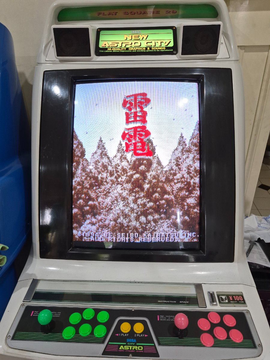

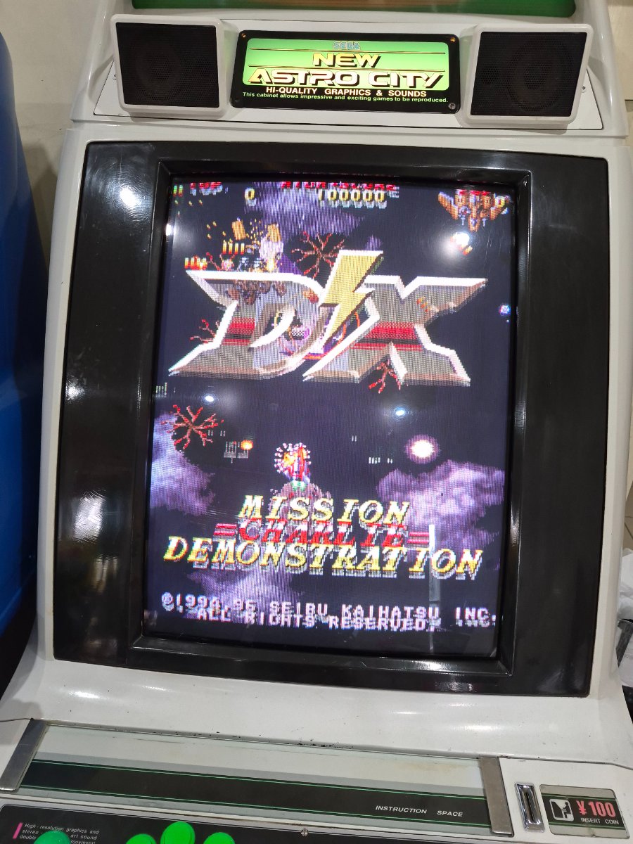

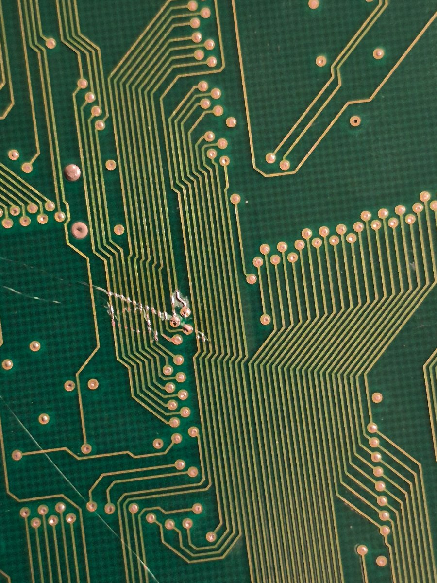

I got this one cheap as a total black screen job. Did the usual solder fix (yep a ton of loose legs on the customs and ROMs). This got me to black jailbars. A quick look around and there was a pretty bad scratch on the bottom cutting through a number of traces. Once fixed this got me to the picture.

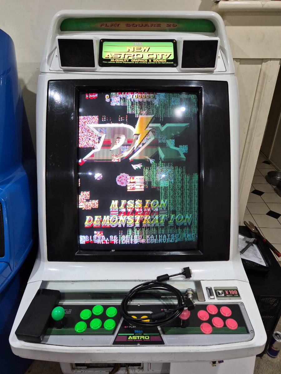

Probed the latches in the graphics region anx nothing looks stuck. Thinking palette RAM mainly becaus of whats there and what isnt. So ill look into a replacement.
