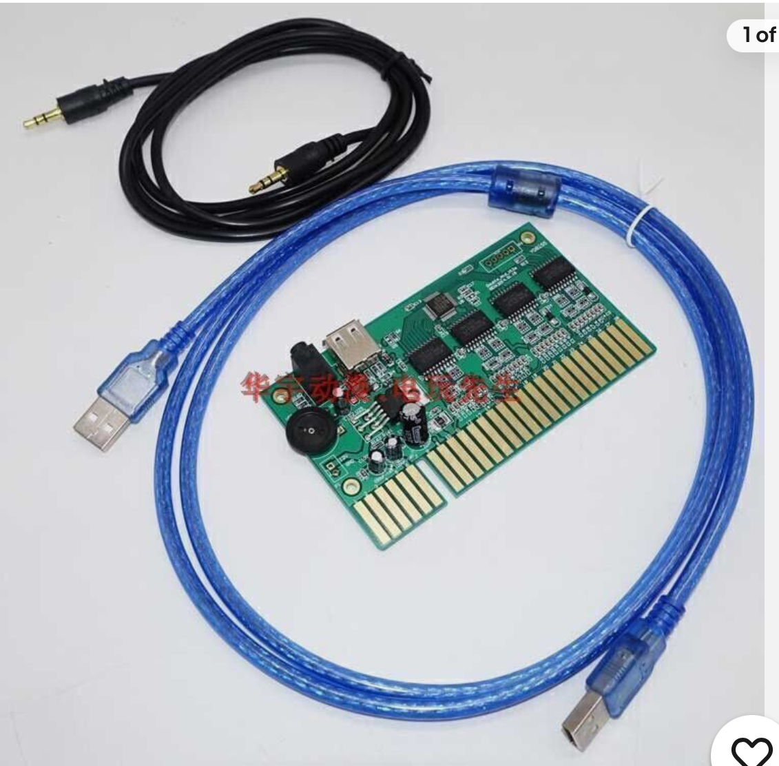

Hi yes I am using jamma, would a USB to jamma converter like this help and completely forget about this module?
I don’t want to change my setup from jamma to USB as two other systems rely on it. (Pandora and a light gun game both jamma)

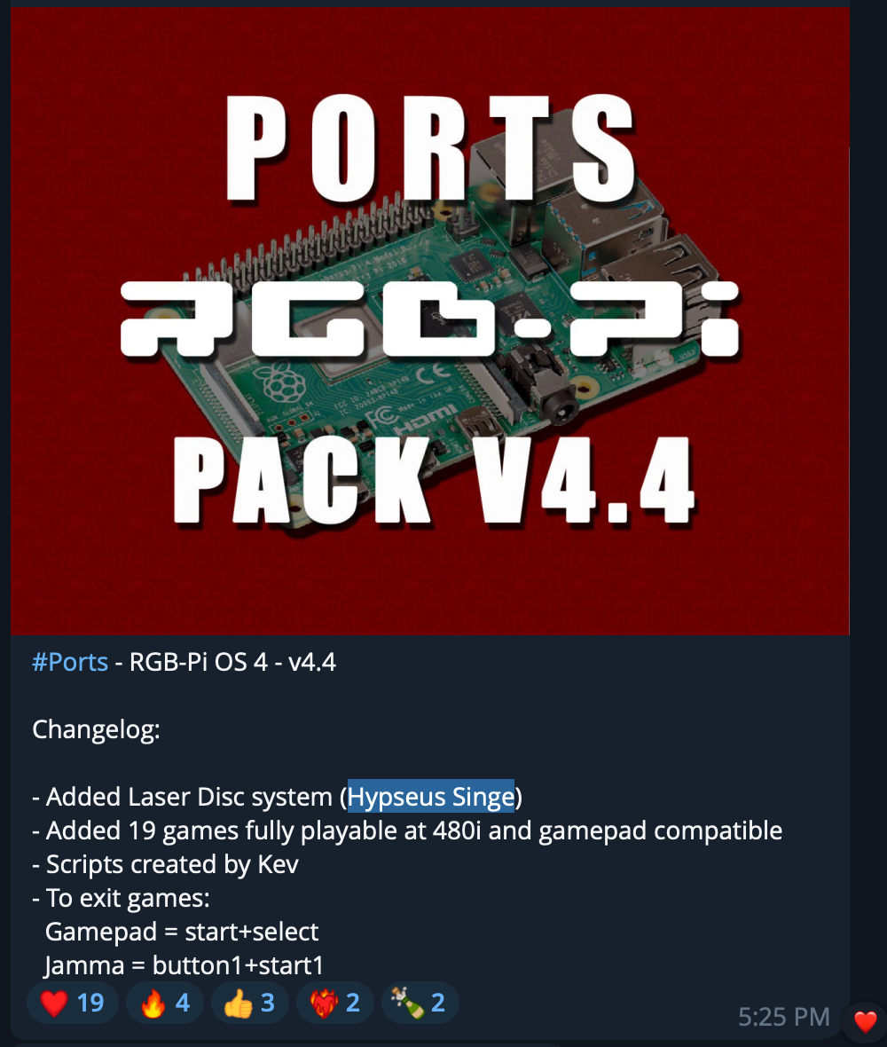

@Baz Baz Actually it's in the official ports pack on the RGB Pi OS now. They guy who originally put them in RGB Pi Extras (KEV) collab'd with the RGB PI OS creator to get it working and in the official OS release. It uses the Hypseus Singe emulator and is available under ports.

Hi thank you but I can’t find any information on this whatsoever, there is info on Hypeseus Singe on google but nothing about RGB-pi or ports extra , where did you get this information please and instructions please

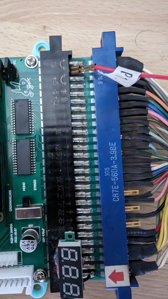

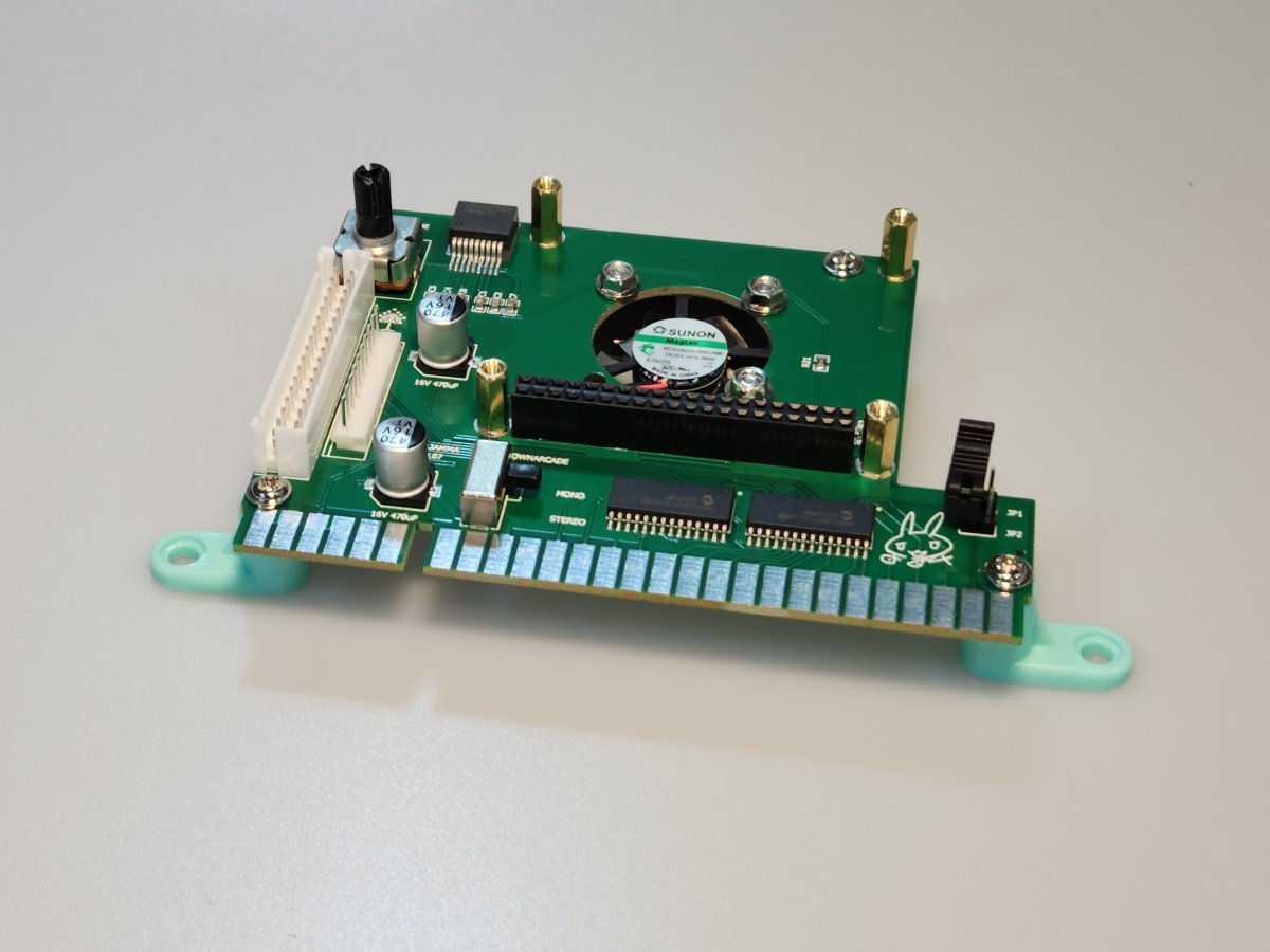

Welp after having this board for months I decided to use the pcb feet and included screws. Bad design, screws are way to close to jamma edge and fried my audio amplifier on the board. Only able to get sound out through audio jack on pi.

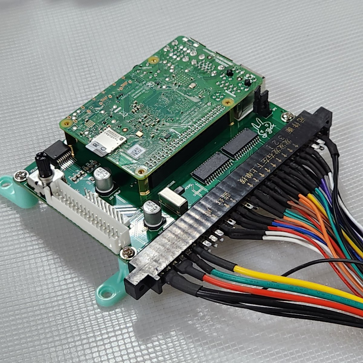

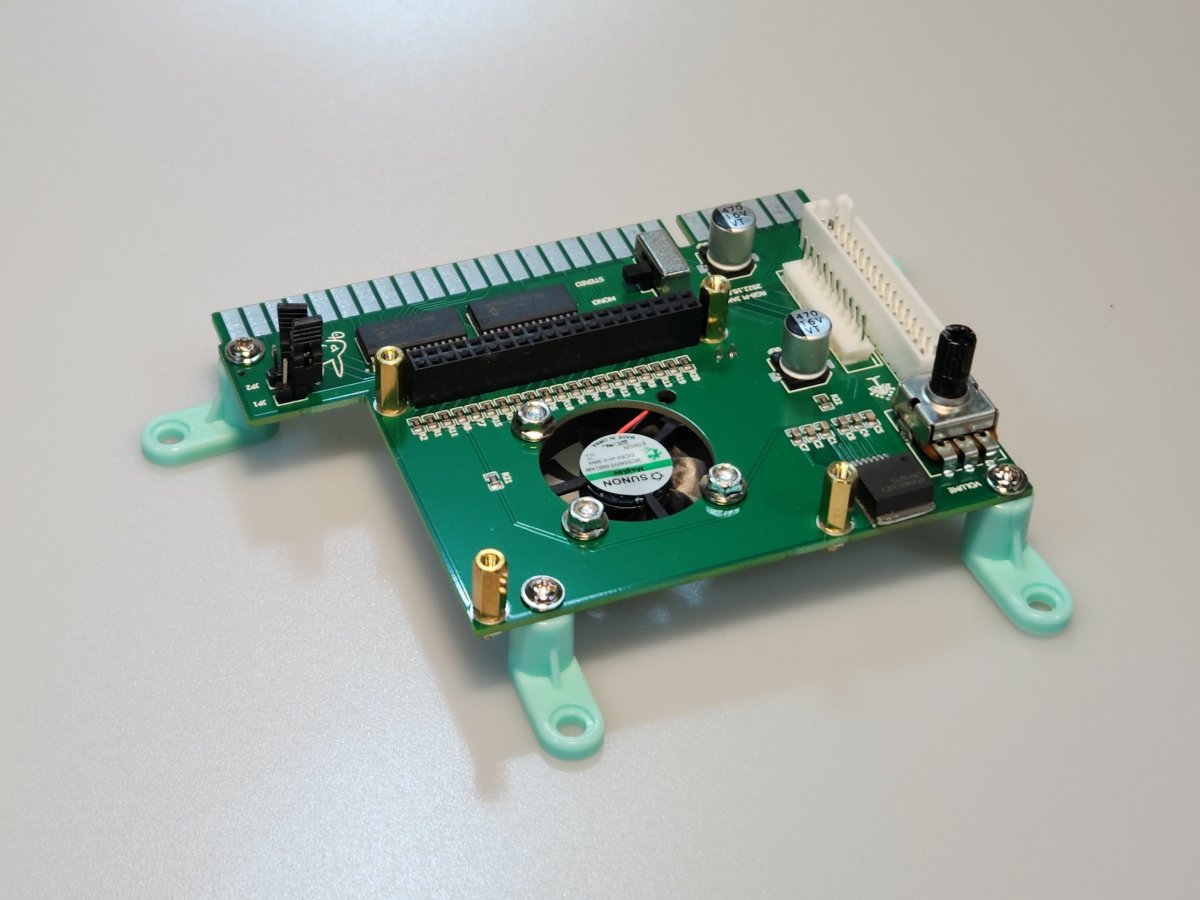

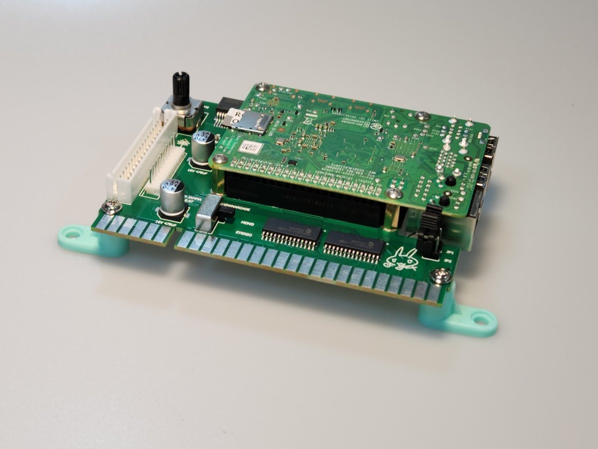

I made Raspberry Pi TO JAMMA Interface. It is compatible with VGA666/ MCP23017 and also works on RGB-Pi OS4
This board is compatible with Raspberry Pi 3B+ & 4.
It has Cooling fan to prevent the Raspberry Pi from overheating, kick harness and amp & volume knob. And Les Lock makes it easy to mount this board in a cabinet
https://www.ebay.com/itm/204368012484
https://bit.ly/43JaYyv
