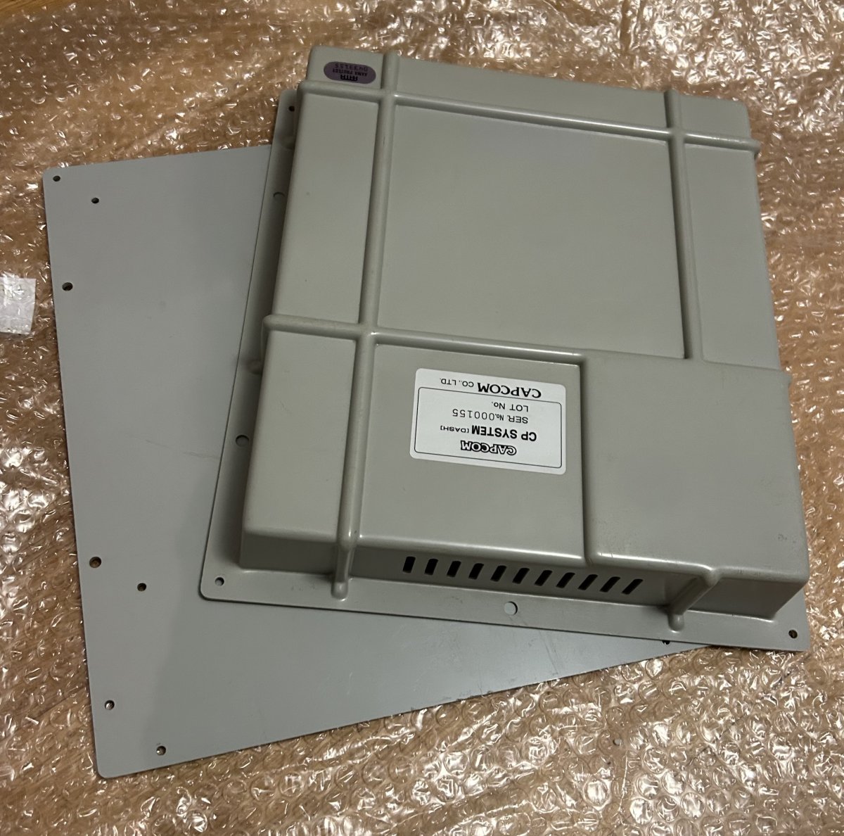

I have this one for years, hoping some day reproductions would be cheap and in same quality (not 3D printed), to use in all my cps1 boards
Mine has the small bottom part, intended to be used with small mobos, but a larger one also exists for bigger ones.
Games with kick harness connector on the C board wouldn’t be a problem if a hole is placed conveniently.
That's an ideal part for vacuum forming . That's how the originals were made. The longer variant just has a longer bottom board which is just a flat piece of plastic with holes in it. the top is the same on the longer variant.
I have a few of these myself but they only fit a few cps1 games. Anything with c board connectors (like street fighter 2, knights of the round, mercs etc) won't fit. And neither will boards fitted with the cps 1 infinity key
Yeah, I didn’t realize that the kick harness connector isn’t the only thing to take into account, but also the size of the C board having it.
A small redesign of the top piece, specially making that square a bit taller and wider, which is where the C boards is placed, would work.
I dunno if changing that is really a feasible thing

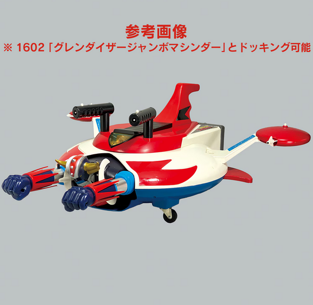

I got down this rabbithole from seeing a reproduction Grendizer Spazer a gent made online (they usually run north of $10k) and it looks remarkably close to the real thing. I've missed a couple opportunities at buying one of his repros in the past few years, and figured I could make my own.
Anyway, that lead into what he used for a vacuum bed, buying a set of plans, buying half the parts, now at a standstill needing to buy some very pricey parts unless offerup gives me a deal. Have space for a 2x4 bed, but electricity may limit me to 2x3, but even that's big enough for 95% of arcade uses, and is just about the right size for making my own version of the Spazer! For a bit of scale, Grendizer's about 24.5 inches tall.
Been looking at this a bit. Wonder how you'd go about the grill holes on the side.
Could you take a pic of it flipped upside down?
