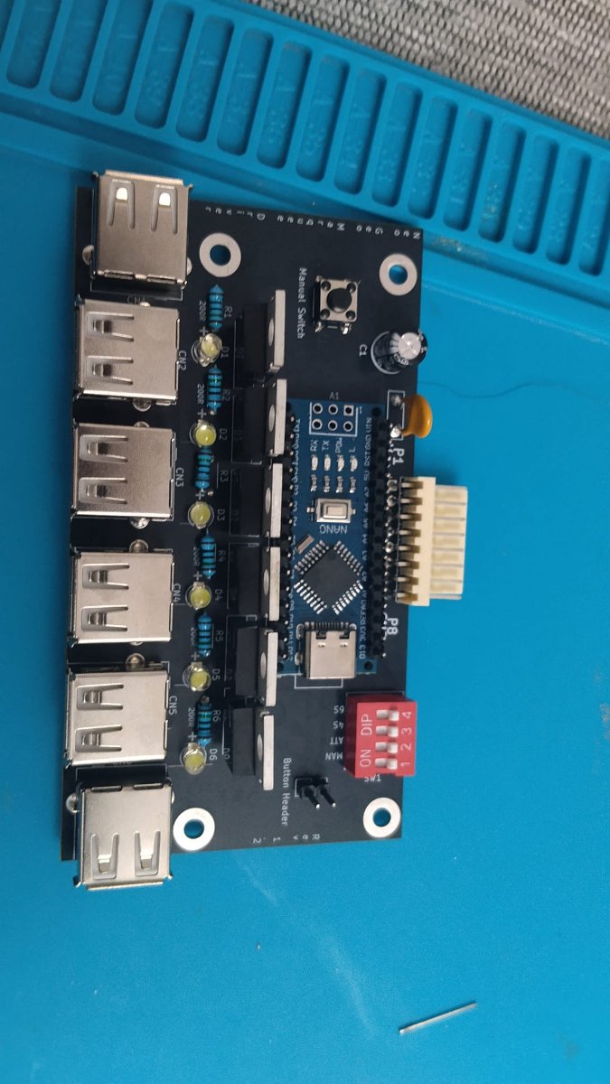

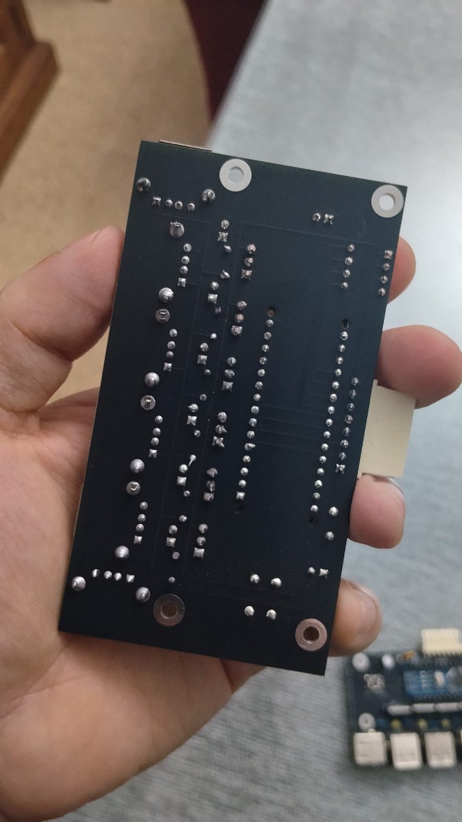

I'm waiting to receive a Neo Geo SC19 that I bought from China, it's currently on its way! I saw this post and it’s been super helpful, thank you so much. I'm not very skilled at soldering, but I think it turned out pretty good. Once I get the EL panels and the Neo Geo home, I'll test it out. THANKS A MILLION!!! :D:D

Hello guys, I have a problem, I just tested the boards for the first time today and the following happens: if I connect the board to the neogeo mvs 4slot through the EL panel, the board does not work and the arduino starts burning, on the other hand, if I try to connect the board through the USB from the arduino to the PC, it works correctly, do I have to modify the EL cable of the MVS or something? What am I doing wrong? I hope you understand what I mean
Sounds to me like you have the cable reversed - all black cabling doesn’t help
The Vcc and GND are labeled on the board and match the pinout on the MVS board. If your pinout is reversed apart from killing the Arduino your clock and data lines will be incorrect and your lights will not show in sequence
Beep out the power and ground lines on your MVS board using a multimeter to make sure you have your connector pinned correctly
Well, I’ve checked it; the cable is fine (wired 1:1). The issue lies at the output of the MVS EL it’s putting out 17.5V DC instead of 5V... I don’t understand why, as the MVS itself is working correctly.
