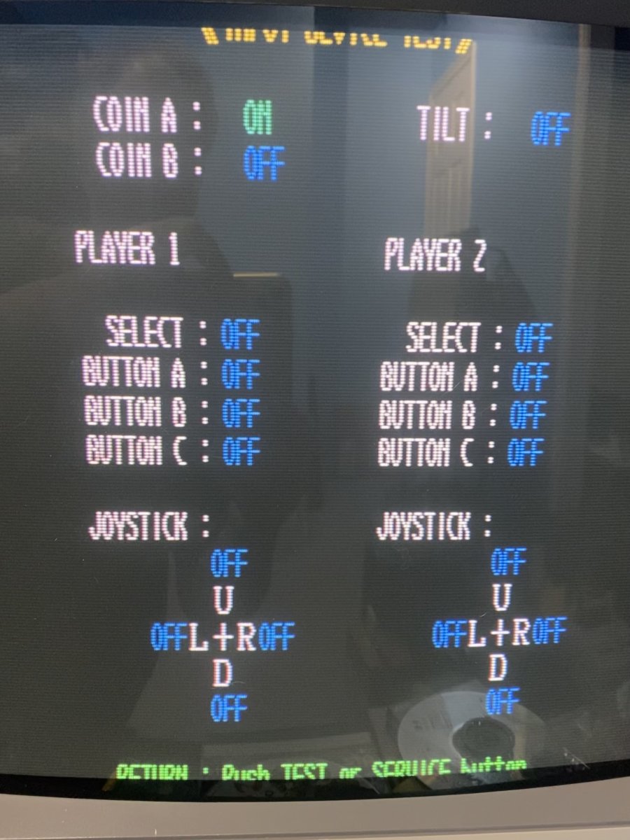

This board had an issue where Coin 1 was shorting to Ground, causing games to constantly reboot with a Coin Error message. Enabling DIP Switch 4 lets you access the Service Menu at least.

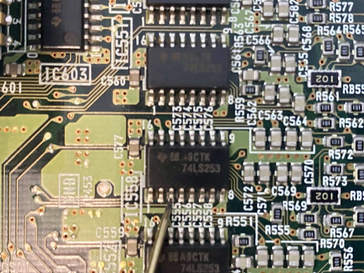

I traced Coin 1 from the JAMMA edge, through a few vias, resistors, and capacitors, and finally landed on Pin 3 of IC558.
Sure enough, when I tested this pin for continuity with ground, it beeped through on the multimeter. None of the other 74LS253 chips did for the same pin.

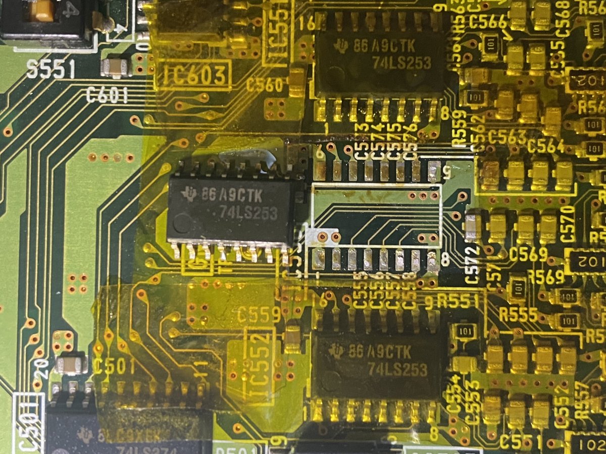

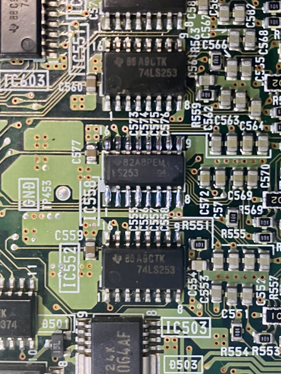

I carefully desoldered the failed 253 TTL, and swapped in a fresh one.

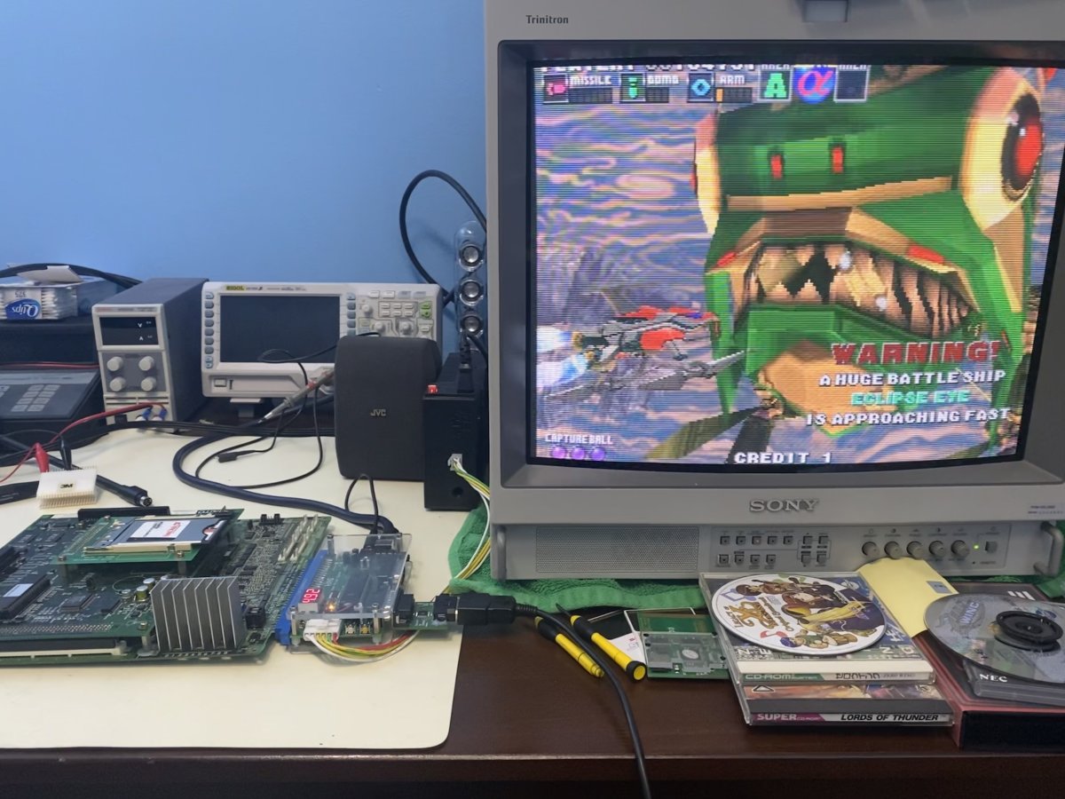

Now the Coin 1 input registers correctly. I played a full round of G Darius to test things out, then left it to soak test overnight.
Happily, everything still functions correctly one day later. Successful repair! :thumbsup:
nice, but why the capton tape?
the surrounding parts wont be effected by the heat - just get a bit of a reflow :)
and get blown away without the tape if you work with hot air.................
Exactly. I’m using hot air to evenly melt the solder on the SMD TTL, and I don’t want any of those tiny nearby SMD resistors and caps to shift.
lol - thats why you turn the flow up and down :)
