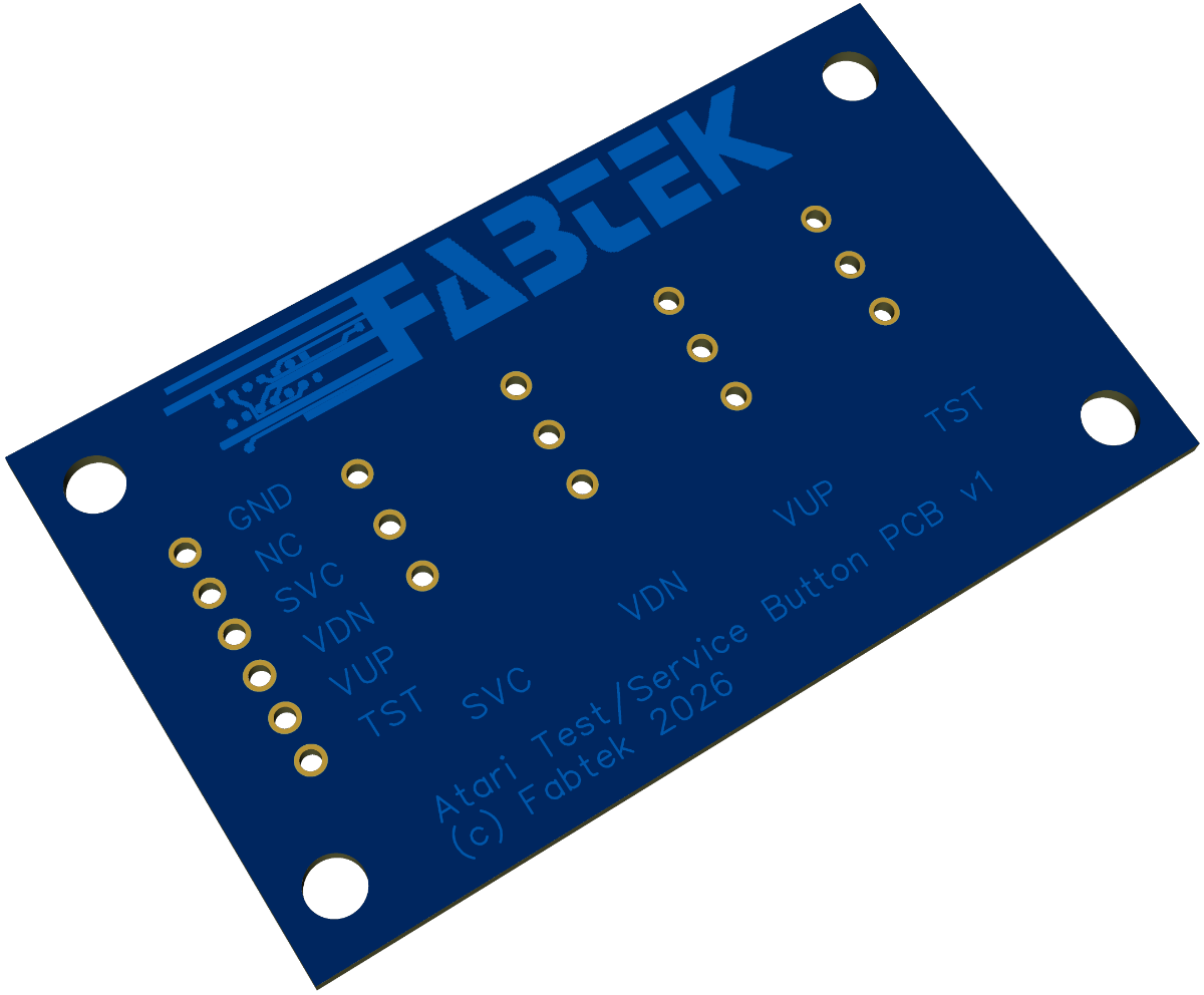

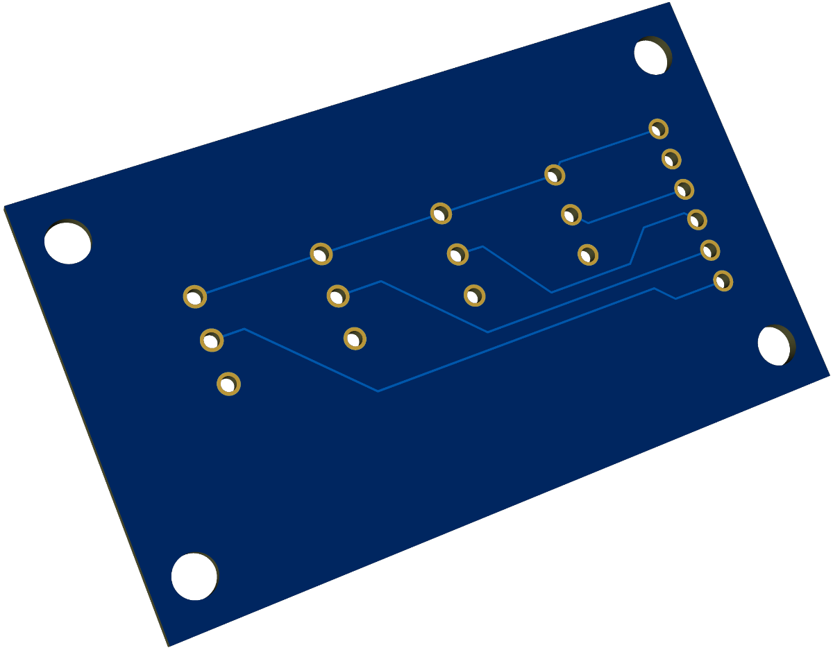

Drop in replacement for Atari Part Number 5763-13376-00. Pull requests and feedback welcome since I am not a PCB design expert. BOM listed in repo, just 4 micro switches and a Molex KK 6 pin connector.
