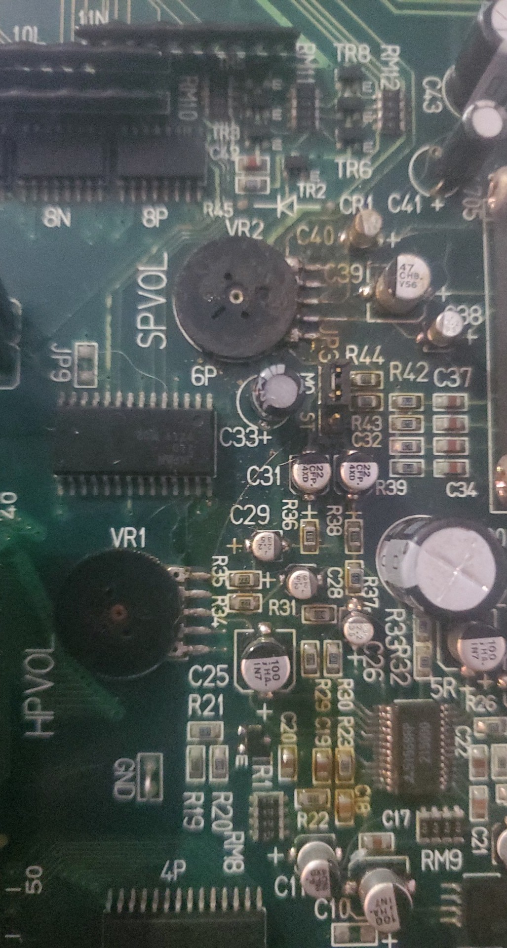

@GC8TECH just curious as these look like the same ones namco NA1/2 use do you have a board you could test them on as if they are a match I could use a 2 more making 3 i need.
been looking for ever for a wheel that would replace the ones on a namco na boards.
I think the Namco wheels are diffrent..... BUT i DON"T have any namco boards here... Do you have a picture of the wheel on the Namco board so i can check??
T.

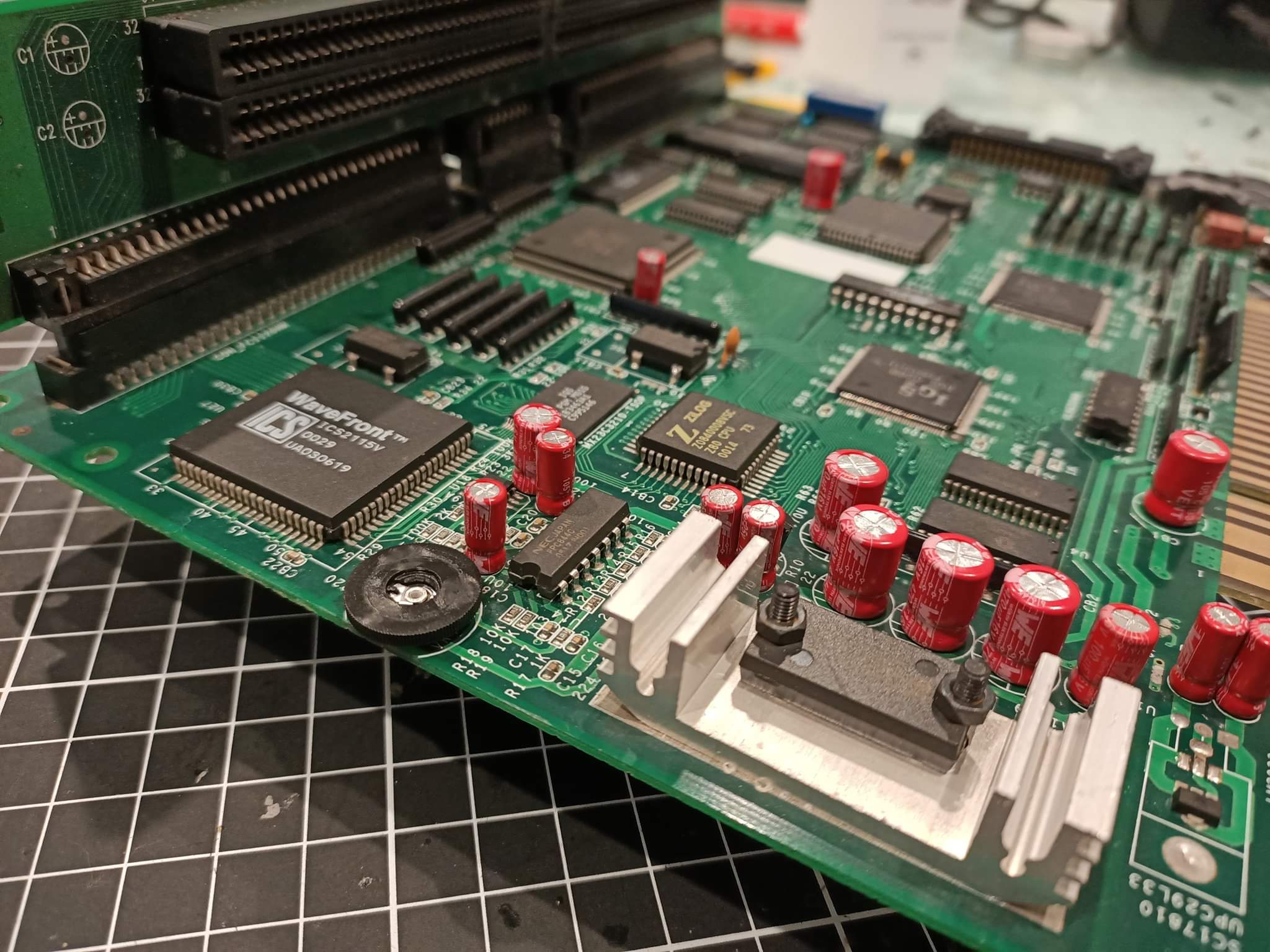

Received mine today.
Great stuff, identical replacement.
Sounds so nice now, no more hissing and popping when adjusting the volume dial. Clear audio all the way.
You the man! Thank you.

there not the same as namco na1
  • USER_SCOPED_TEMP_DATA_MSGR_PHOTO_FOR_UPLOAD_1593224837730_6682469309791508729.jpeg
@GC8TECH ya i can find ones that look like them its very hard though. But no idea what the ohms is of the original. The ones on namco system 11 are suitable replacements
To measure the resistance properly.. you will need to remove it from the PCB. You could measure it in place... BUT the reading will be wrong.
I presume there faulty and need replacements anyway?? Ohm values for this type of pot are normally written underneigh them. which would help you. i presume there is no value for it writen on the PCB?
