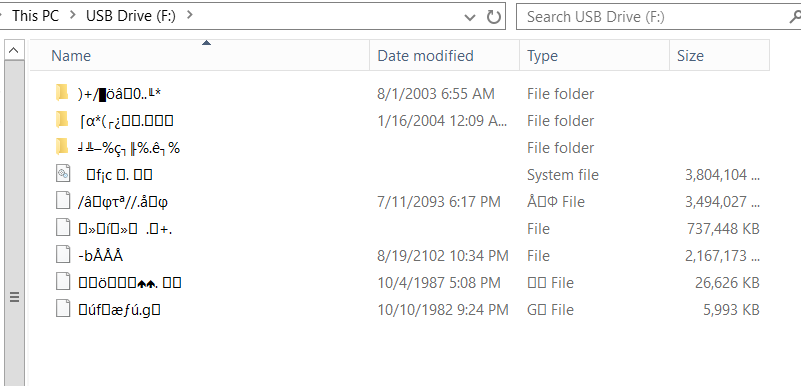

This produced a .bin file and a file with no extension. Both titled cap-sf3-3. WinHex requires a .iso file to write, so I used a simple .bin to .iso program to convert it to an ISO. i then went and clone the disk to my F: Drive, which is the microSD card, and when I try to use it in my CPS3 system it says that it's an invalid CD. If I look at the microSD card on my computer, it's garbage. Just a bunch of odd symbols and whatnot for file names, and completely nonsense file dates/times.
Is there something I'm not doing right with chdman to get the raw CD image out, or is it something with WinHex?
I appreciate all the help here. This is really driving me crazy.
As an FYI, here's what the contents of the MicroSD look like after WinHex clones the .iso file. Complete Garbage, and the system doesn't recognize it as a valid CD. Are the MAME .chd files useless for trying to burn the CD image?

Someone else used the restore image function to write their card. I wonder if it is necessary for MAME ripped ISOs.
What game disk are you trying to clone again?
