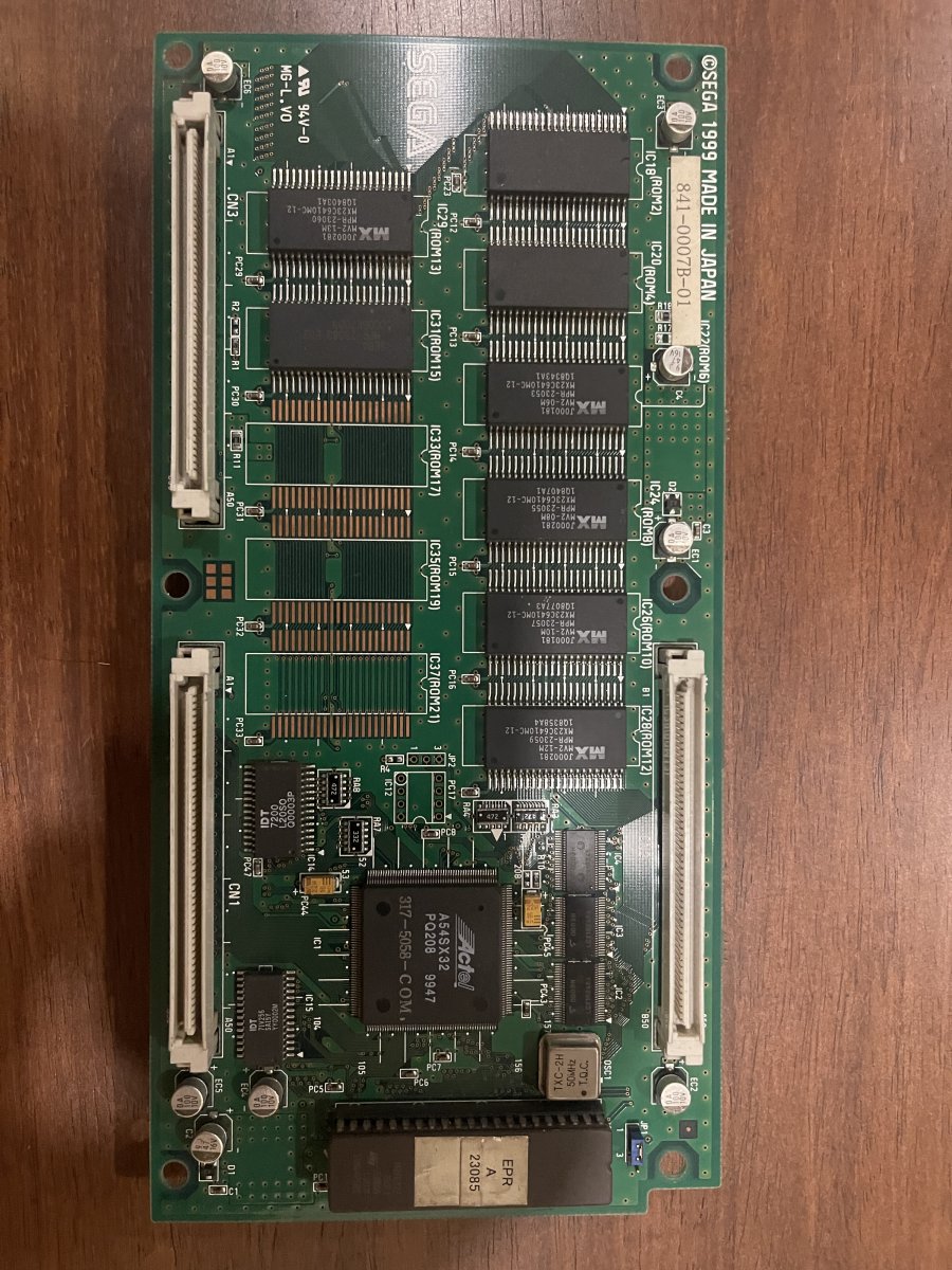

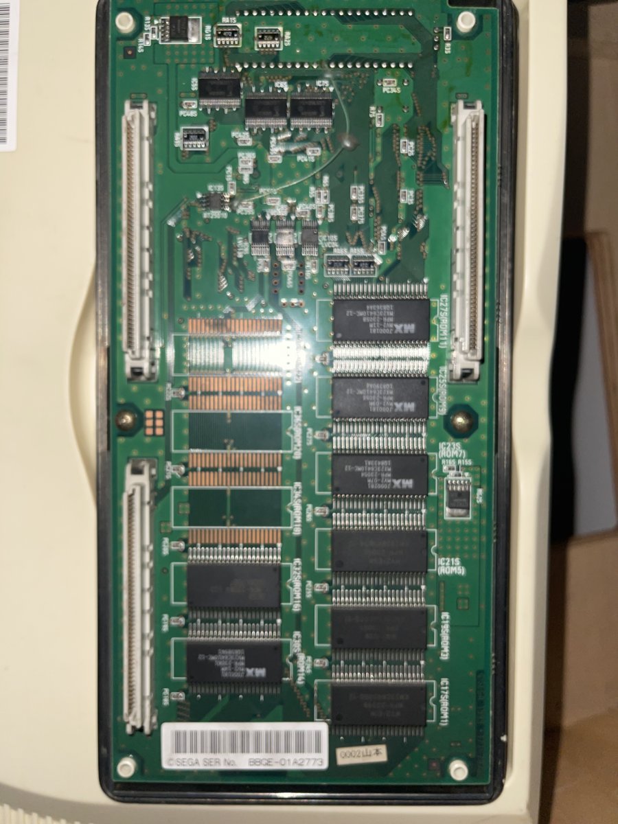

interesting, your battery is already removed. I'm surprised it's saving settings at all? You may be using the already unlocked chars rom? Did someone make/convert your cart or is it original?
That’s a good question, I’m gonna ask the seller. Any other pics able to help determine?
This is the cart.
those look like mask roms that say mv2, so i think it's legit? bbge seems right for serial number according to a quick google.
