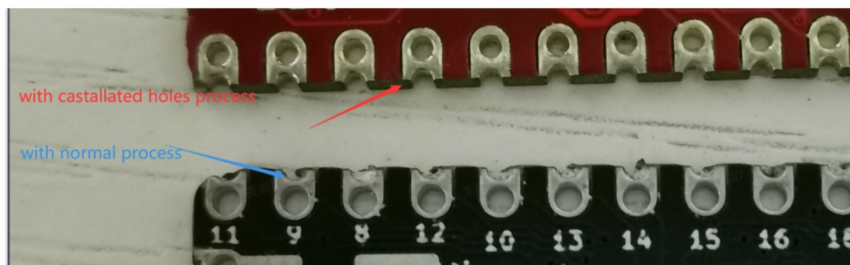

Hi Alex,
Thanks for your reply.
To proceed with castellated holes processing, you will need to modify your Gerber files to meet the requirements shown in the below image, and there will be around 35USD extra cost per order. Shall we activate replace file button for you to modify your files and send you extra cost to pay?
Or should we proceed with normal process with the risk of possible defects? Please kindly advise.
Best regards
Olivia
i know @ManCloud received same answer about manufacturing , but maybe this can help for the future .
I proceed on JLCPCB to normal process (like how the zip is on github)
This is for guys who wants castellated 0.8mm thickness for 161 in 1 daughter boards to be manufactured, with 35$ usd additional cost - 5 x double daughter boards =>
so the price can be 42 : 5 = 8.4$ USD

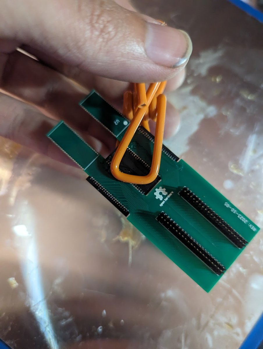

I'm also using a chip bag clip to hold the chip in place while I lay down the first side.

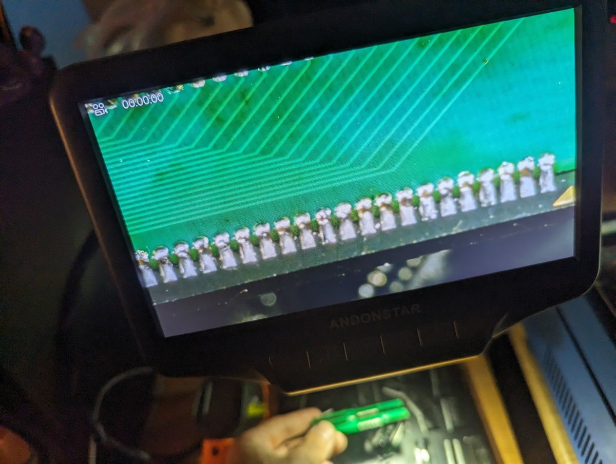

I don't have a microscope which I don't think is helping. I think I'm beyond the limits of soldering by eye here
It certainly wouldn't be accomplishable without one for me. And it's harder to check what's going wrong when you can't see it happening in the moment and have to keep going back to using a phone to take a zoomed in picture.

The single daughterboard is easy to work with, once you figured out the technique. Look at it under a microscope and use the tip of an exacto knife to clear the cut holes. In some cases it's just getting the fibreglass filler out, in some cases you need to cut out the extra copper ring left behind. You need to check both sides of the PCB for any left over copper. Finally, flip the PCB on its side and check all 4 edges. You should see clear copper in the holes (no fibreglass) and no 2 holes are touching (just clean fibreglass wall between the holes)

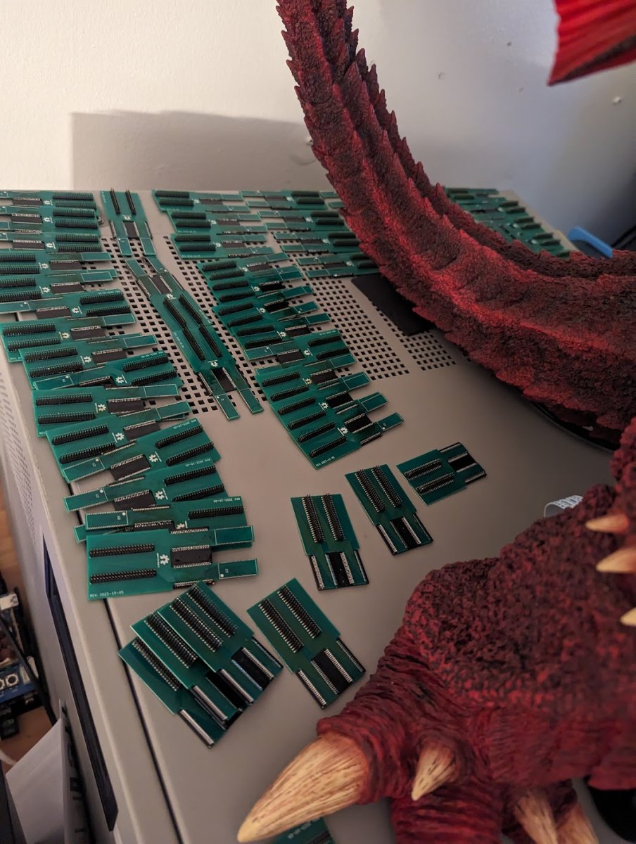

I'm using Ack's, and they look the same as the dual ones but without the extra chip space. I haven't made many though, as I'm not having any real struggles with the STILT daughterboards.
I can send you some if you'd like. I ordered 150, but so far have used 3 because the STILTs seem just fine if you remove them with care.
