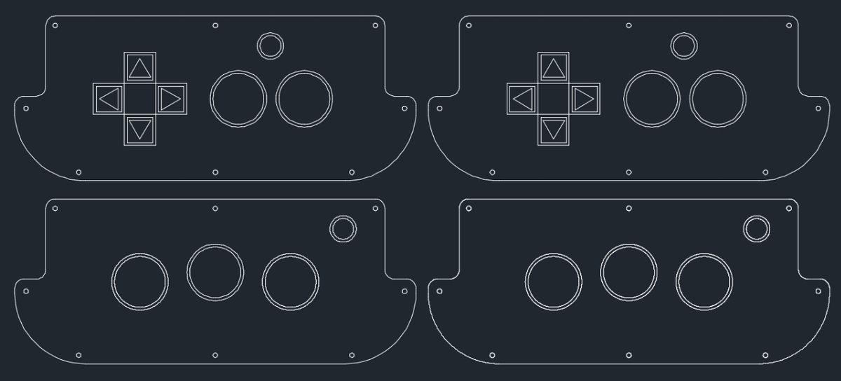

I'm planning to use it on my mini cabs and I had a bit of time to mock up a couple of 'vs' panels:
(Bonus Bishi Bashi Vs panels below ^^ )
I'm planning to use the CCFL outputs to drive some other LEDs on the cab too. Can't wait to bring it all together :thumbsup:
