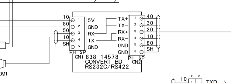

838-14592-XX series of boards need to convert the rs232 from ringedge/wide seriel port to rs422 which the servo boards use. The ringedge/wide PC doesn't talk rs422 so converter needed.
838-15069 can do both, rs422 or rs232, by switching a jumper.
The small square board that came in dedicated ID 4/5/6/7/8 cabinets breaker out wires from com1 (rs232) and then sends rs422 converted out to servo boards to the 8 pin header CN2. If the sega converter board is faulty that a generic converter can be installed (see picture).

And it is very helpfull, as I had no plan of this rs232/422 thing before I got this problem. So thank you really very much.I can use ANY converter? Thats great, they cost nothing, good to now when it should have a error with that in future.
