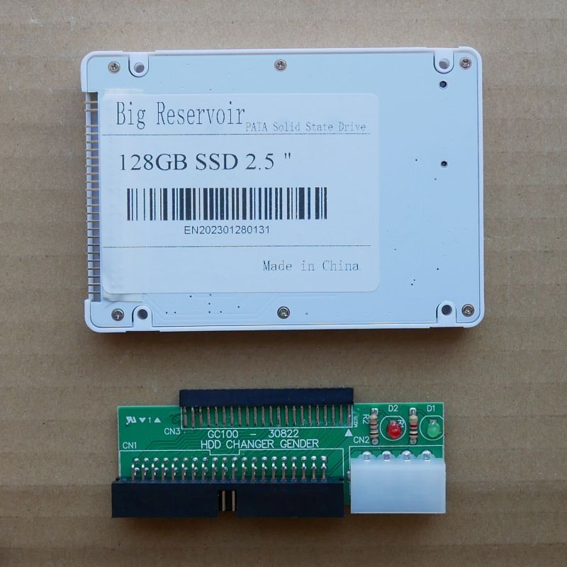

Big Reservoir 128gb 2.5" PATA SSD and a 44-pin to 40-pin adapter
Result:
It doesn't work. The access light doesn't even turn on. Super disappointed. The drive actually supports quite a lot of ATA commands, including SETMAX.
Has anyone tried a large CF card? I think that's pretty much what's left for options. A 128gb card costs 80 euros here. Not sure I want to spend that money to try it out.

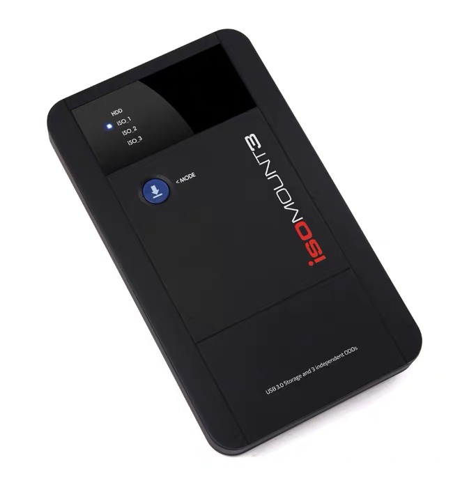

South Korea SKY simulated virtual optical drive mobile hard disk box 2.5-inch USB3.0 SATA3 solid-state mechanical high-speed box
It can simulate iso and HDD. Can this device be used?
It's USB. How could it work?
If I use this IDE to convert to USB, I am not sure whether the IDE cable has 5v DC power,
It's a stupid thing to do, but I want to try it anyway.
Maybe the final result is that it can simulate an optical drive, but it is not a true ATAPI DVD-ROM.
2X6 BIOS supports ATAPI IDE HDD or CD/DVD-ROM. The optical drive and hard disk IDE remain independent of each other and cannot be overlapped and accessed in parallel. Only one of the two can run.
ATA-6 (ATA100)
The ATA100 interface and data cable are the same as ATA66. They also use a 40-pin 80-core data transmission cable. The ATA100 interface is fully backward compatible. Devices that support the ATA33 and ATA66 interfaces can continue to be used in the ATA100 interface. The ATA100 specification can easily deal with the difficult problems of ATA33 and ATA66 interfaces. ATA100 can enable the external transfer rate of hard drives to reach 100MB/s. Seagate and Western Digital both use the ATA 100 standard.
