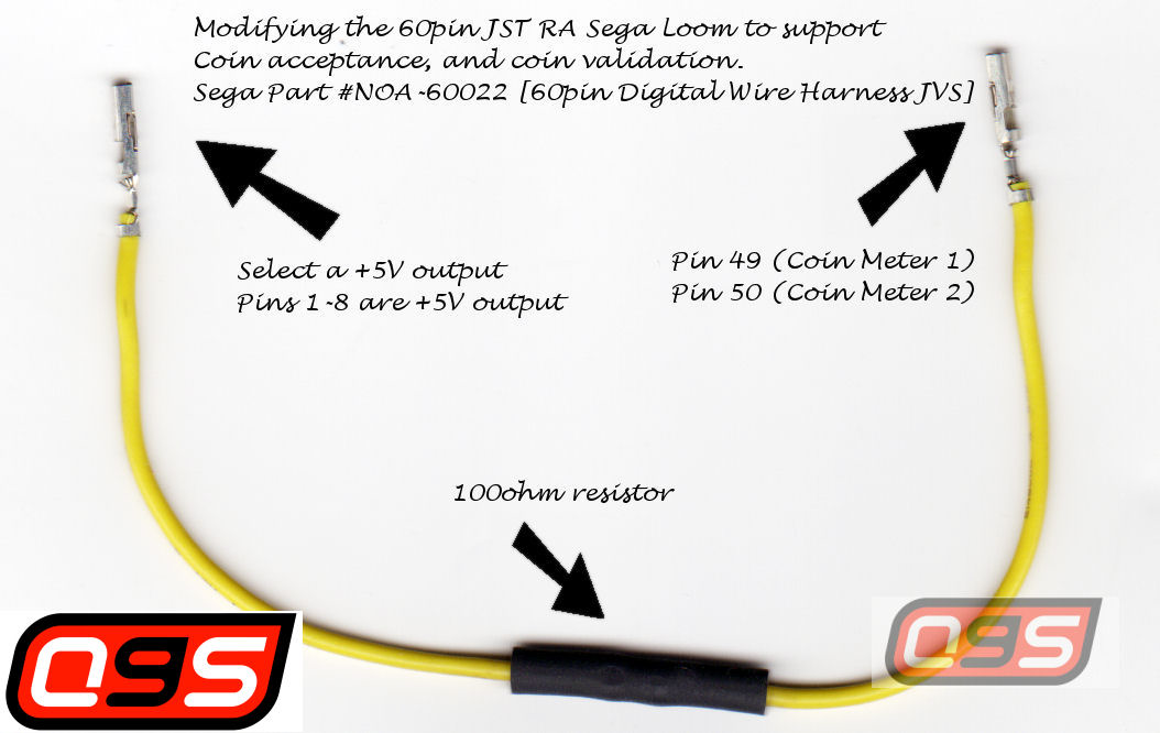

Did you ever solve this? I have the same issue with a Naomi 1 with the same IO board. Credit doesn't work, also Directionals are all stuck high on the JVS test. I read a few places that without a coin meter this board has issues, there is talk of wiring the coin meter pin on the jamma edge to +5v with a 100ohm resister in line to spoof that. Apparently what I read without the coin meter this board, and other Sega IO boards won't register inputs. For me Test/Service/Start/B1-B5 all work as is.

You need to spoof the coin meter on these I/O boards. It’s as simple as adding a resistor as @clintkolodziej suggested:

I used 120ohm resistors, I saw something where an official Sega document mentioned to use that resistance, can't remember where I saw it though but anecdotally others say 100ohm works as well.
Thank you both, added the resisters and credit input all working.
