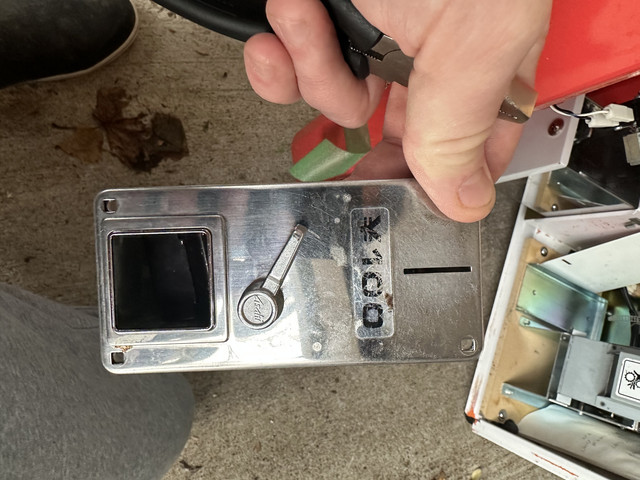

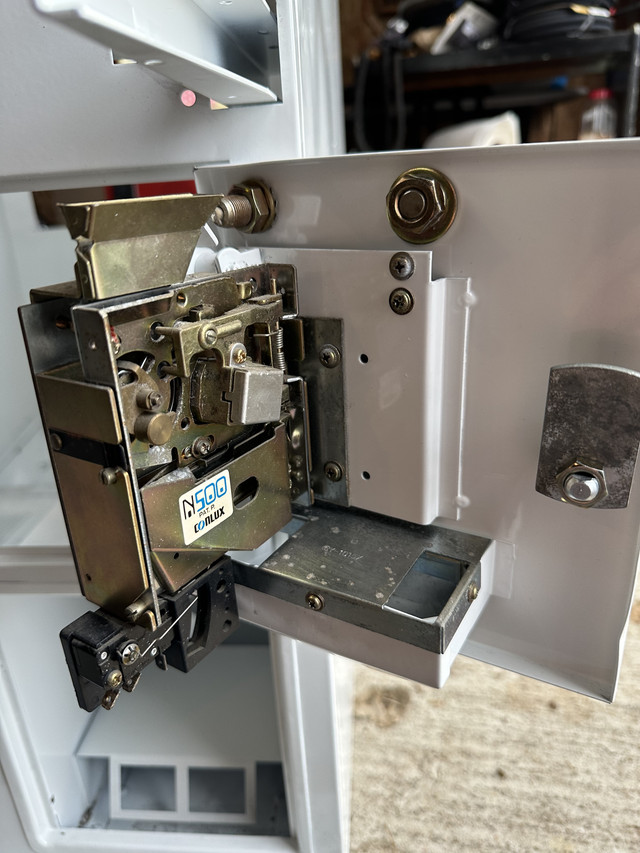

I went to assemble my coin mech and change shutter but it was dingy, so after a soap and a grease, I was ready to tackle it.
The installation went smoothly. I noticed the coin door supports two coin mechs but I haven't seen an Aero CP with 2 Yen slots yet. Curious..
I installed the lock with the straight tang in the coin door, but I have HUGE gap between the coin door and the tang. What do I do to close it?

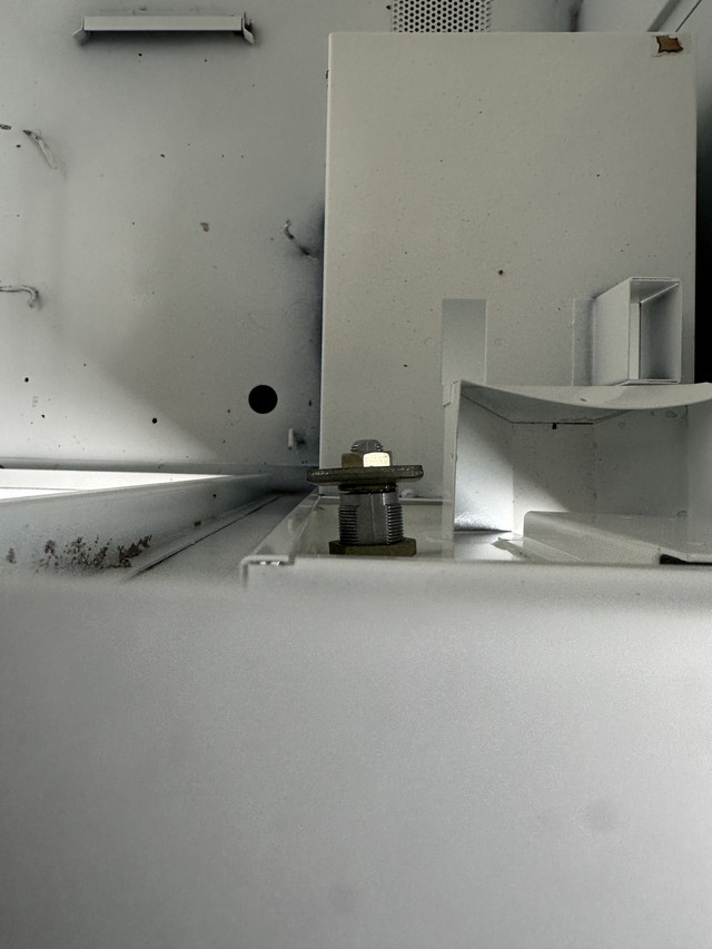

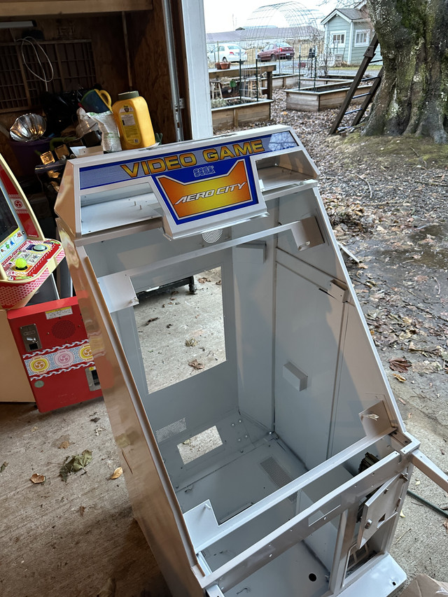

I secured the topper with a few nuts and secured the nuts to the topper piece, (that were awkward to get to) to save me a bit of trouble later..

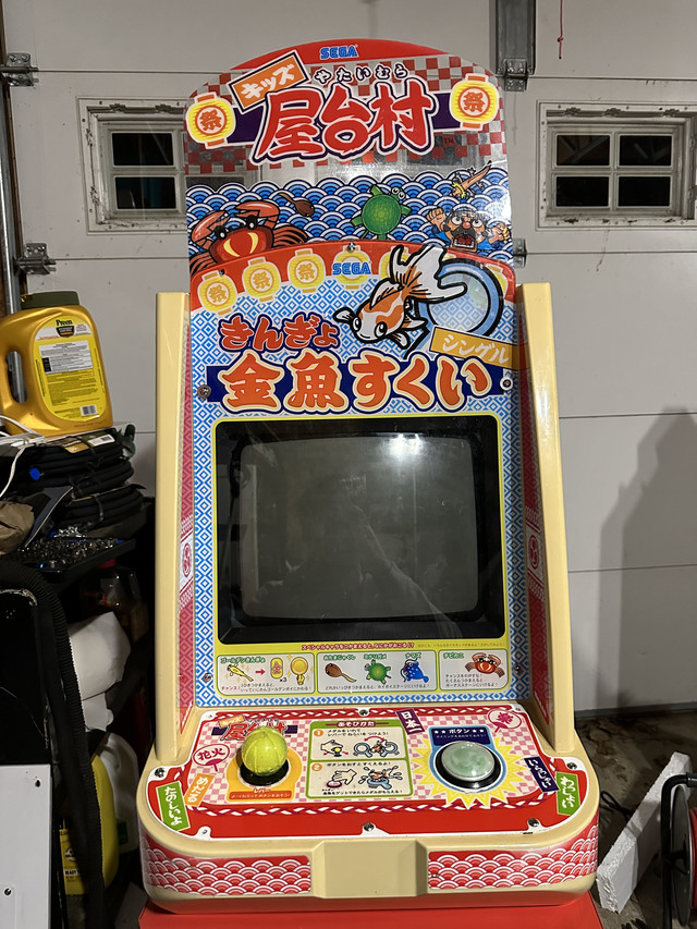

I felt less bad about checking out the new cab after some basic work so I decided to crack open the "Sega Goldfish"
The front lock was missing, but I found the lock, keys, tang, and second coin mech laying inside the prize box..
The key cylinder was jammed though and wouldn't turn. I have some experience in re pinning and setting the springs but will save it for another time. I wanted to close my JAMMA door so I decided to rob the lock from the coin bin and change out the tang to the door lock.
Success. I can close the door and lock it! Woo Hoo!

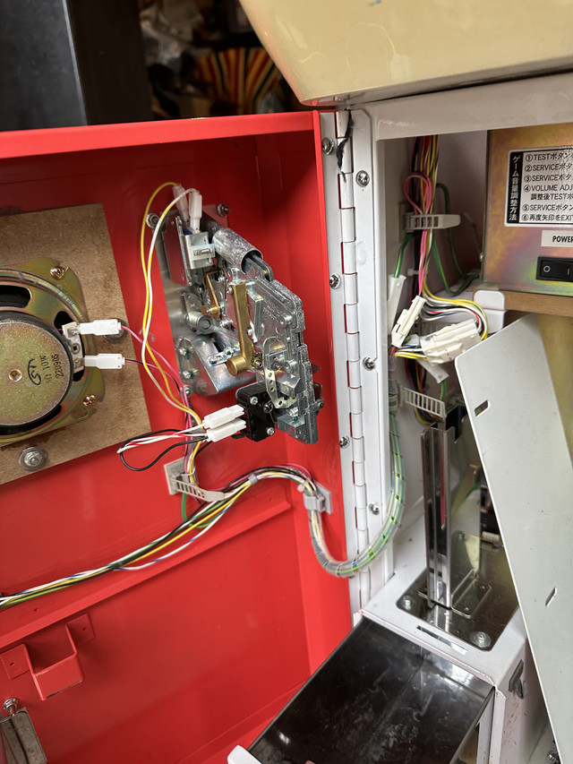

I decided to install the second coin mech..
The leads were all there so it went smoothly.

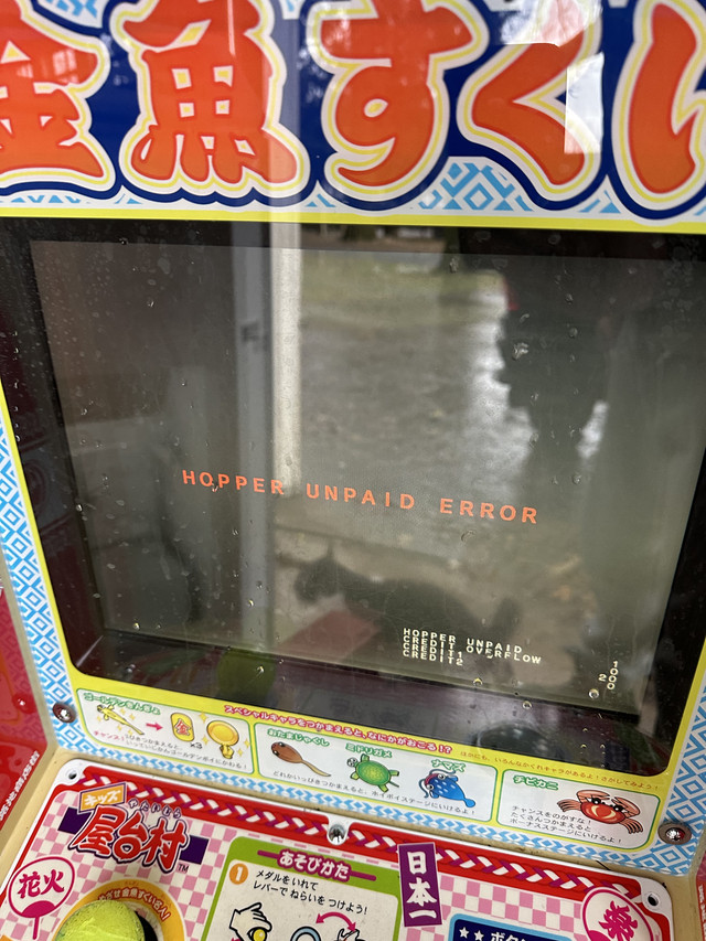

TIme to turn this thing on and hopefully play some Goldfish!
"Hopper Unpaid Error"?? DaFUQ?
I found the hopper but couldn't clear the error.
I noticed the first coin mech fed the hopper so I tried putting in 100Y.
No dice. What kind of tiny coin does this mystical machine accept?
After messing the service menu I was able to spin the hopper and dispense yen but I still cannot clear this error.

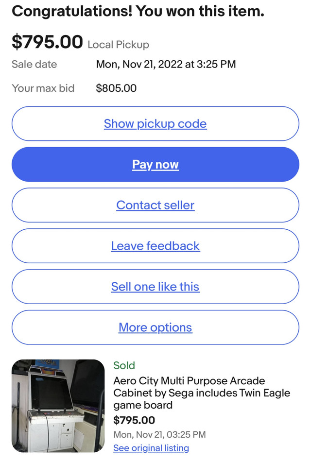

Also coincidentally I won ANOTHER Aero City off of ebay for $795 with a Shmup in it. So I guess I will have another parts cab after I restore this lol
That's awesome! I was in talks with the guy who was selling these Aero Cities. Unfortunately, I had things pop up that prevented me traveling to pick one up. I think it's strange browsing forums and finding an eBay ad that you were stalking again lol.

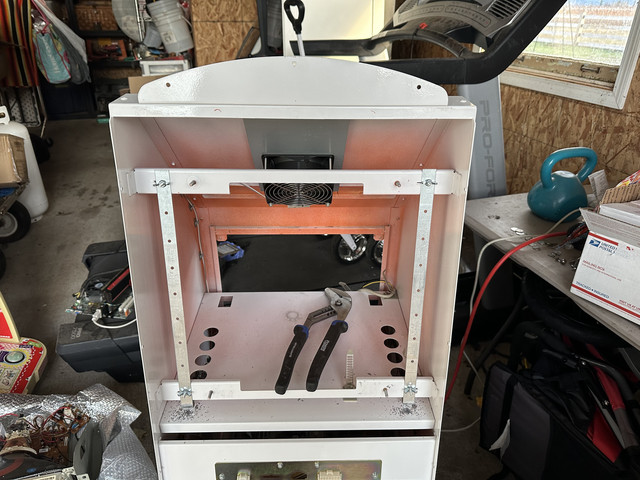

hoagtech
Mar 28, 2019
1,658
2,423
Bellingham WA
The powder coaters are backed up.. Still..

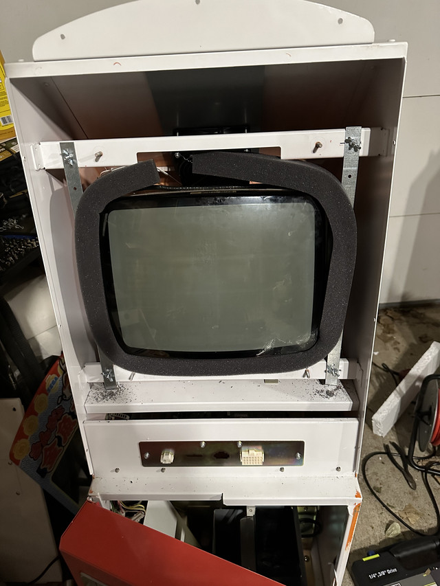

So that gives me another chance to take on the Sega Goldfish cab I recently acquired.
The first thing I want to tackle is the LCD replacement.
LCD begone!
I had to equip myself at the hardware store next.

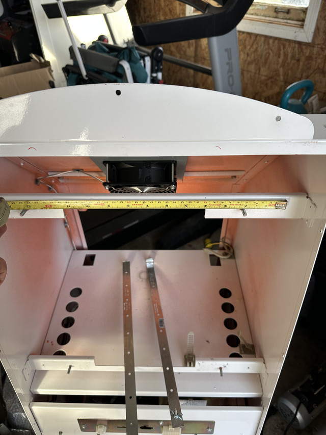

I chose smaller bolt sizes and thin strut so I could wiggle and tighten my CRT monitor in case it didnt align with the bezel.
I started with a measurement of center for my strut posts.
(I noticed this cab has never been CRT as the factory welds supported the frame of the LCD..)
I took a play out of @SNK-NEO-GEO 's book and bought some slats of steel to mount my CRT monitor
The centering went great as I used a straight edge along the existing LCD mounts as a guide
After some trial and error. I finally got it mounted and centered. The problem was the CRT stuck out more than the LCD and wouldn't close on the LCD bezel.
So I got some spacers and installed them behind my strut until the center of the monitor was barely touching the bezel.
The hardware store had irregular parts so I had to drill out 3 out of 4 spacers to fit the thread.
After mounting, I noticed the LCD bezel was bigger than the CRT so I had to close the corners in gasket material..
I now have a 13" Arcade monitor properly mounted and ready for the next step. JAMMA......

Very cool man. I've been wanting one of these little Dino king clones to do the same and make a mini Aero, Blast and Astro. Really cool stuff

Regarding the CRT - I came with the same conclusion as you on my first cab but on my second cab, I looked online and there was a post and pictures on how the CRT fits with the “LCD” mounting brackets but they are actually the CRT original brakets and those four plastic thing goes with it as well and it is a perfect fit.. I ended up drilling holes on the “LCD” brakets to mount the CRT. It was a long time ago when I did this so I don’t quite remember the link to what I am talking about but I will see if I can find it later.
SNK-NEO-GEO
Enlightened
Jul 21, 2015
3,568
2,512
Virginia
there is a picture there that shows exactly what is going on.. The mounting of the brackets is different for the CRT than the LCD.. but the way you mounted yours is good if you are going to tate the CRT but you have to cut the metal horizontal bars.. Also, @alberto1225 is creating some custom panels which to my palm rest are perfect..I did not like the the joystick was position from other panels projects.
https://neilsarcadediary.wordpress.com/2022/06/18/dino-king-conversion-part-3/

I noticed the AC plug had this coupler on it. I would like to purchase the plug end if it’s available. (Purchase links welcome).

nem
Legendary
May 29, 2016
5,847
6,007
Finland
That's a Molex connector. Just by eyeballing it I think it could be 6.30mm pitch, but I could be wrong. Here's a 2-pin receptacle:
https://www.digikey.com/en/products/detail/molex/0003091022/61318
https://www.molex.com/molex/products/part-detail/crimp_housings/0003091022
Check the pitch with a caliper before ordering. Remember to get pins as well.

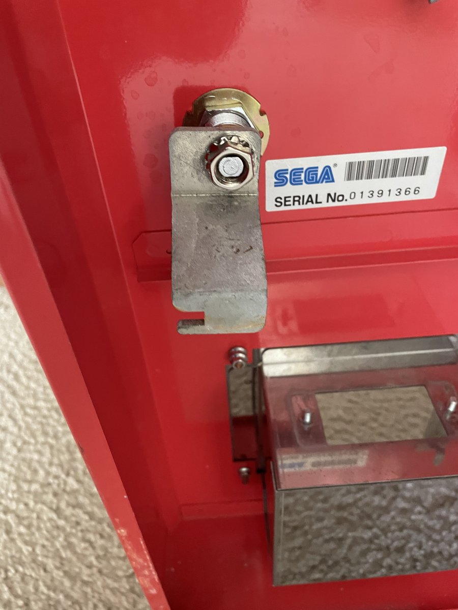

That's not the correct Tang, you need an S shaped tang (CY-1018)-

Sorry, I missed that question.. here is how it looks like..
I believe the question was for my Aero City.

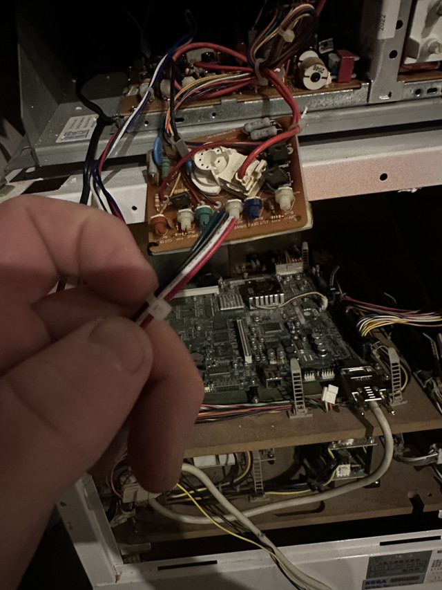

hoagtech
Mar 28, 2019
1,658
2,423
Bellingham WA

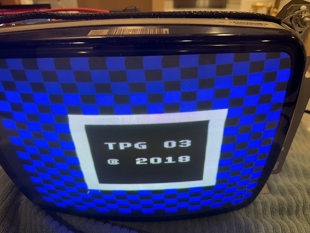

I plugged my monitor into my isolation transformer setup and ended with a green screen and a whiny pitch from the anode cap.
I wanted to leave it here before I hook up the PSU and JAMMA and hear your thoughts on this…
hoagtech
Mar 28, 2019
1,658
2,423
Bellingham WA
The green screen made me uncomfortable. I didn't want my first attempt at wiring a Jamma to a PSU halted by it so I brought a second opinion device and checked my wiring..
First I made sure my ISO was setup properly by checking my setup guide for my test bench. Everything checked out
Next I had to unsolder my RGBS connector from the PSU and tie it to my Craftymech Test Pattern Generator for my "second opinion"
After messing with my H and V sync and a few sync modes on the Crafty TPG I was able to get a stable image.. Besides the gambling burn it was juicy one at that!
I have a TON of 13" CRT donor but I wanted to make sure the chassis was capable before I started that process.. It turns out this monitor liked to display green with no signal but at least I determined that fact instead of assuming a failed component.
After remounting and soldering my AC and RGBsVgr. I had no time left to check my JAMMA wiring. I'm feeling ALOT better then I did with the last test...
Next is JAMMA test
Shout out to @KaPH33n for configuring my TPG solution..
