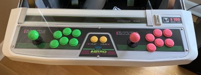

New control panel has arrived! A week ago, I purchased a reproduction control panel, instruction space sheet, and locks from forum member alberto1225. With EMS shipping, it took only 1 week from Taiwan to Seattle (we are living in amazing times!). The quality of both the panel and sheet are excellent.
This cabinet came with faded pink buttons and nice, working Seimitsu sticks. I kept the sticks, but replaced the buttons with Sanwas from Paradise Arcade Shop, using the canonical green/pink combo.
So the panel is installed and looks fantastic. I have new wire looms coming from an eBay seller in Canada and still waiting on the replacement marquee.
