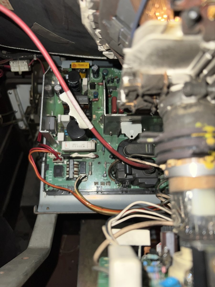

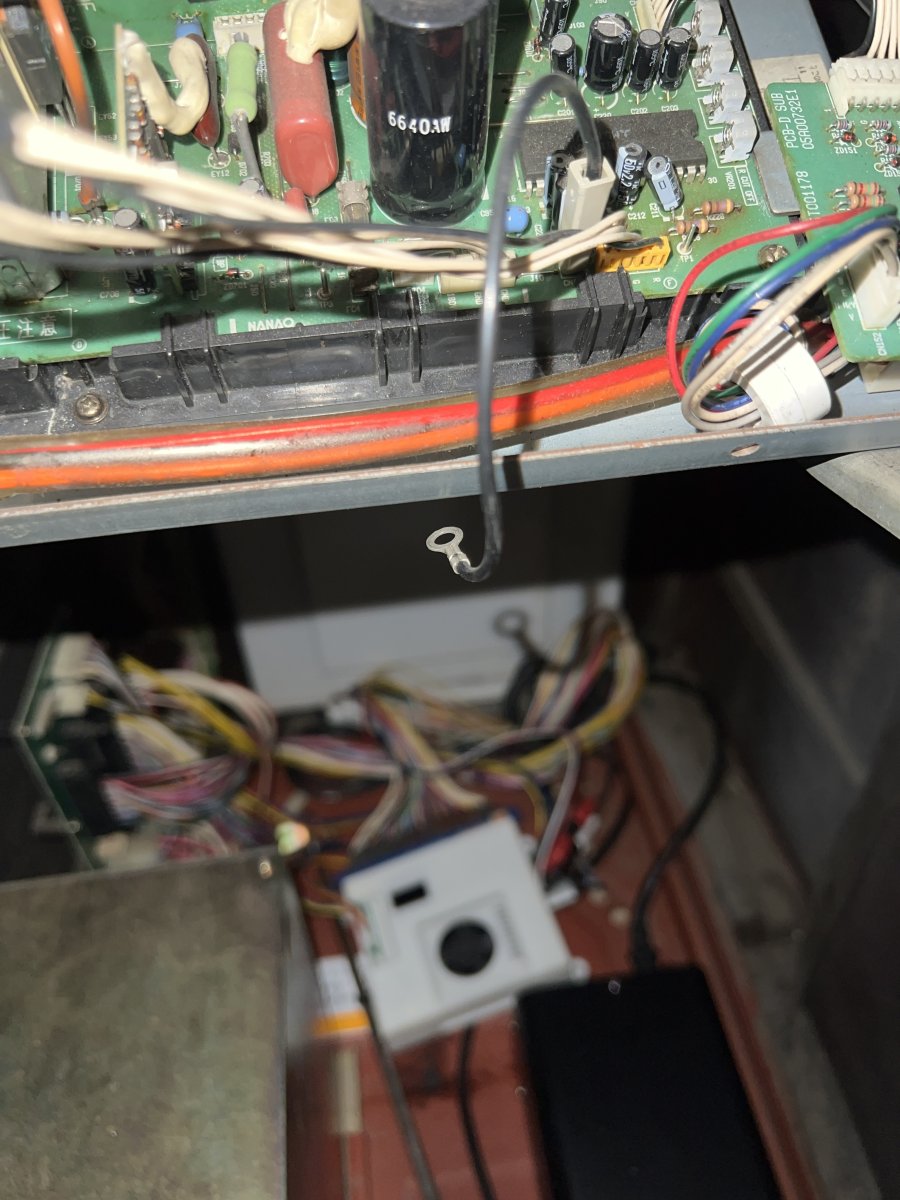

hi team i’ve noticed something on the backplate , it seems that both « ground » connector are not installed , can it cause my issue ? i,ve noticed that the sticking paste is not applied on the 3 white pot next to the tht
