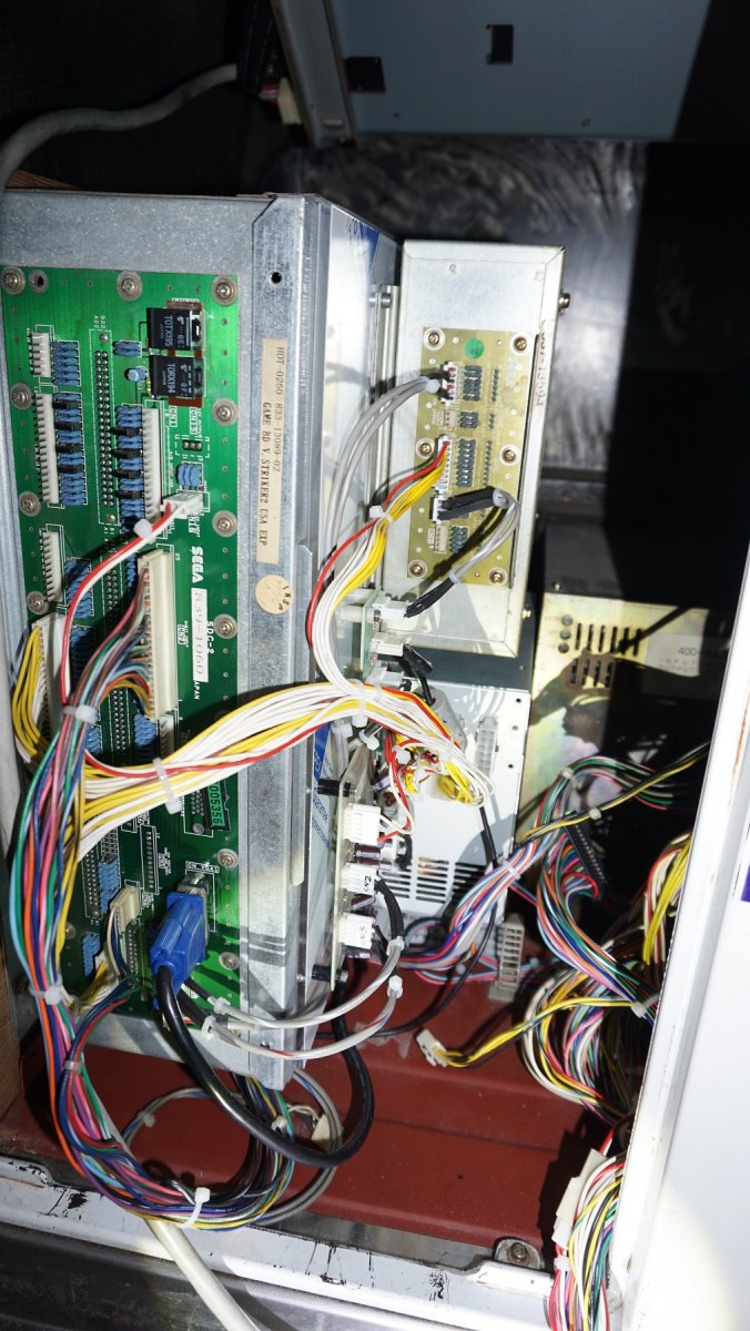

Model 3 is also unstable on this PSU now which is the reason I figured that need to recap the PSU, I've raised it up to 5.2v and it still crashes. In the mean time I'm using a Lindy PSU @ 5v with a modified loom that's powered by CN13 on the Blast I/O. SpikeOut, it's never crashed or froze using the Lindy PSU at 5v.
Model 3 will likely be more picky about +3.3V than +5V.
Max I could get on the Blast PSU 3.3v rail was 2.9v. When it warmed up it was a bit higher but was still prone to crashing.
This is how I'm running it at the moment but would prefer getting it back on the original PSU if possible.
Do you think the cap kit will raise the 3.3v or would I need to start replacing other components too?

I realise i've never published any update regarding this project, and the fact that after a full recap, i got more power but still lower than expected.
Turns out i found out months after the video was shot that the voltage was all around the place when i moved the jamma edge (thanks to the little voltmeter i've added on the edge).
This allows me to trace back to the root of my issue : the sub-board on the right of the cabinet get the power before the jamma harness, and nearly ALL of the power connect solder joint were cracked ...
I guess this might be useful to anyone, because i hadn't thought about this, and this was most likely my issue than dying cap. At least the PSU is more future proof now !
