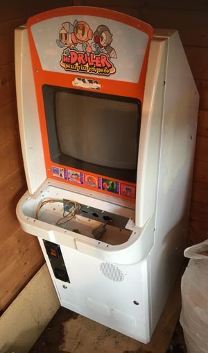

Anyway to start off.. some pics of how they all looked on arrival...

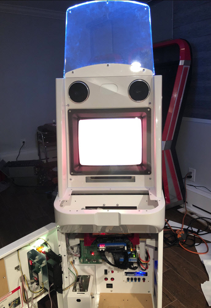

Havent updated this thread in so long, but here are some progress pics, still waiting on some more parts to arrive.
Made some custom mounting plates for the the io and jammafier and to relocated the cabs original buttons etc... The cab already had a jvs psu and I had spare jammafiers/taito io and harnesses so made send to go this route, rather than custom make a harness or put in a cheap low quality chinese one in. Amazingly this cab only had 8 coins on the counter on it and zero on the card dispenser one.
Gotta figure out artwork net and finish tidying up a few other things.
