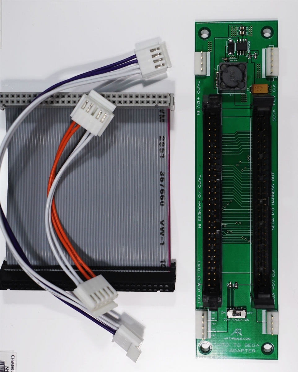

It looks like the type 3 board has 2 sets of mounting holes on the right hand side. The narrower hole spacing looks like it's probably a match for Type 1/1.5. Can you add those extra holes to your design?
Ah ok, yeah, its the revised typ 1 IO. Yup, Ill add the extra holes on the type 3. Il see If I can get my hands on a revised type 1 to get accurate measurements.

Sweet. I think I'm going to be doing a PCB order for some other projects next week, so I'll have them make a couple of these too and I can send you one if you want to do some testing. I don't actually have a Vewlix yet so it would be nice to have someone check that my control mapping is actually correct.

Also, looking at pinout for the sega IO and what @Niko was referring to with the coin meters, I took this off Andy's site, not sure if you are aware of this, most likely you are:
For coin functionality to work, you must either hook coin meters or fool it to thinking coin meters are present.
Also many games require coin meters to load such as Super Street Fighter 4, Street Fighter 4, Naomi games like Lupin etc.
The vewlix comes with 1 coin slot/meter, the taito jvs io 60 pin connector has meters listed as follows"
Pin 47 (Coin Meter 1)Pin 48 (Coin Meter 2)I have to check how the coin meter in the cab is actually wired to the harness. Not sure if its even a concern or needed. I guess if you be easy enough to add 100 Ohm resistors with some jumper pins to enable/disable them on pins 49/50.

Yeah, @Niko and I discussed this via PM. I was thinking of doing exactly that, adding the 100ohm resistors to the board and having jumpers that can be switched depending on your needs. I assume that Sega IO boards expect a 100ohm load in parallel with the coin mech in order to determine if the coin mech has been disconnected "hotwired" to add coins so to speak.

Worked on the design a bit more today. Dimensions have changed a bit so this adapter should be able to mount directly to the Taito IO plate. @Derick2k's adapter plate will be able to be made smaller since it now only needs to adapt the SEGA IO to fit the Vewlix IO plate. I added a switch for the 100ohm coin validation resistors also. Prototype PCBs are being manufactured now. Hopefully I have some updates early next week.
