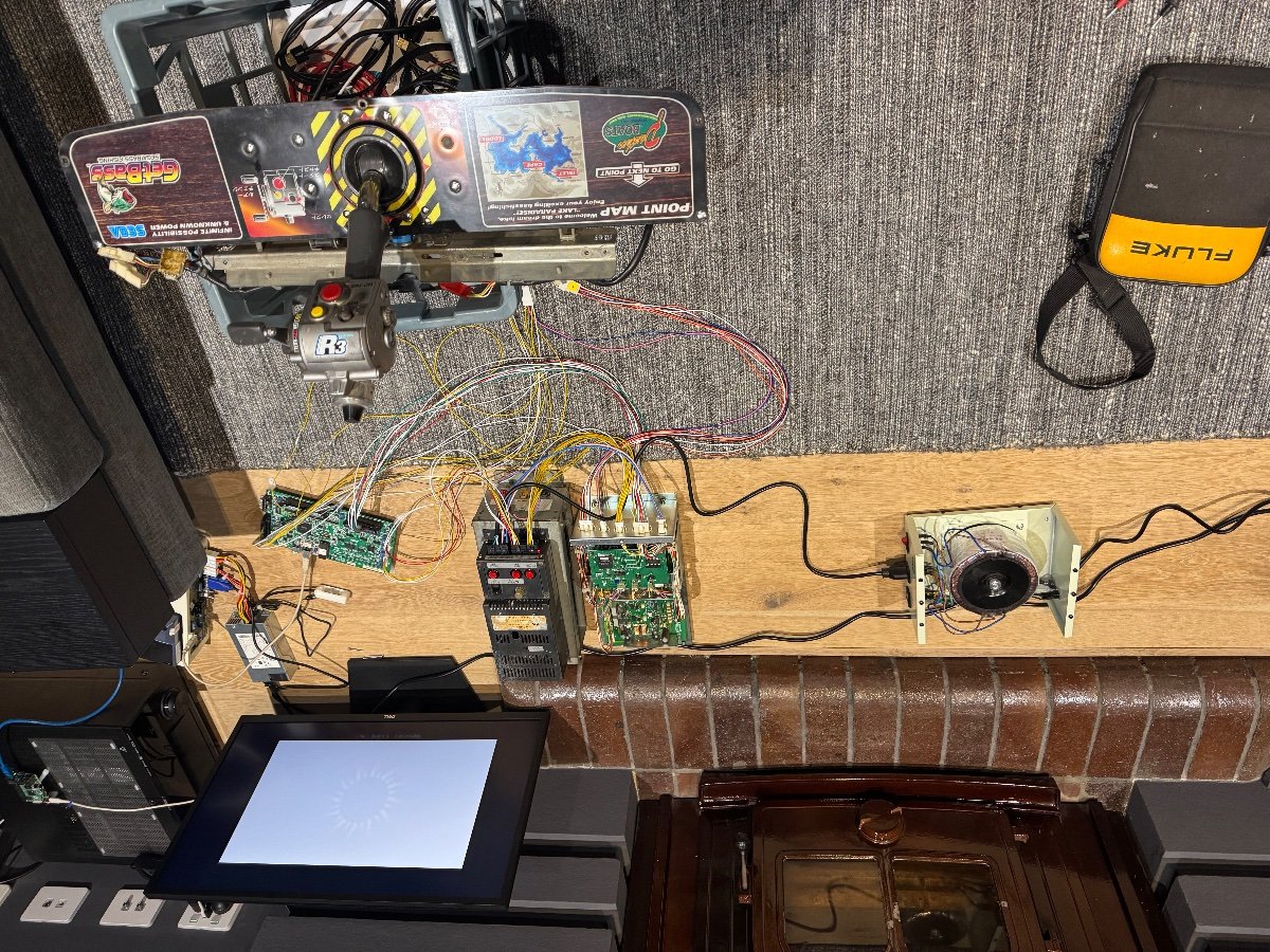

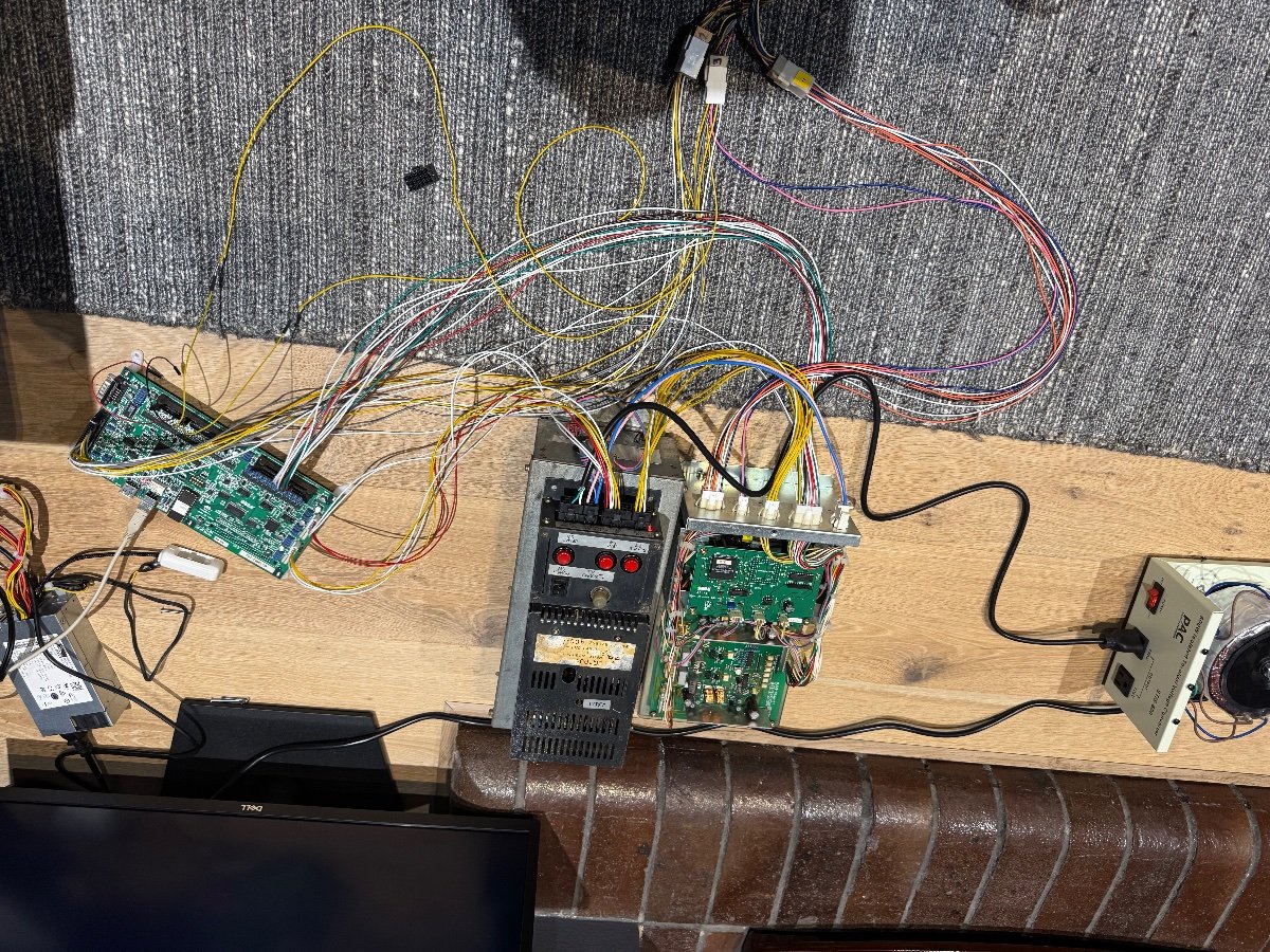

You manual saved me. I was naive in thinking I could reverse engineer the harnesses I needed.
6 digikey orders, 56 wires and about 7 harnesses later I have a fully operational marine fishing cp working on my Naomi. All feedback and motors clutch etc work.
Just waiting on my 7th digikey order with 1000 4 inch cable ties so I can clean up my harnesses
I know a lot of guys have tried prior to the manual being released but I really doubt anyone could have done it with out it.
Thanks again triforce
