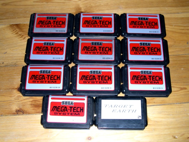

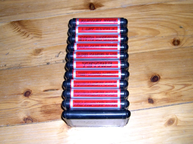

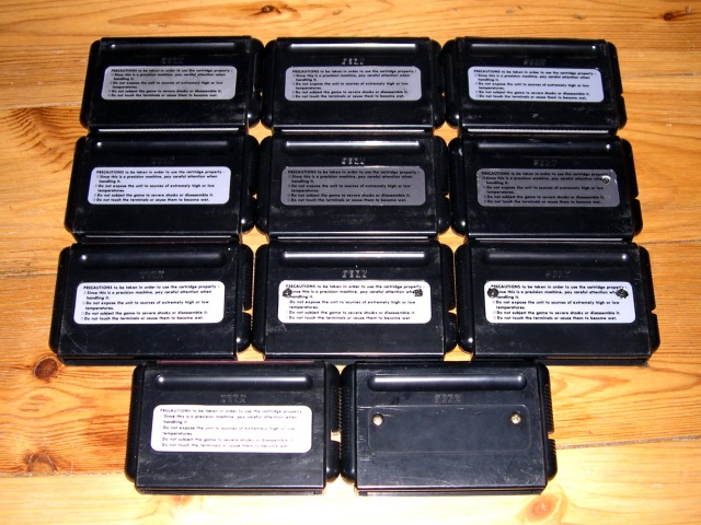

Because someone else asked, embedded are pics of everything I traded to @mar.vetto. An untested motherboard (I know, but this time really untested), wiring and nine carts. Fantasy Zone and Target Earth weren't part of the deal originally, but I told him he could have them for free as long as he would dump them. He said he would.
Admittedly, I remembered Fantasy Zone wrong. It was the original one, not II. That one has been dumped after 2011. Still need Target Earth!
EDIT: by the way, this is a good example of how different the arcade market is these days. I had everything up for sale (apart from FZ and TE) for 75 euros. It sat unsold on Arcade Otaku for some time before I noticed Marco's WTB thread and alerted him of my stuff. I wonder what you could fleece someone for the stuff today.
