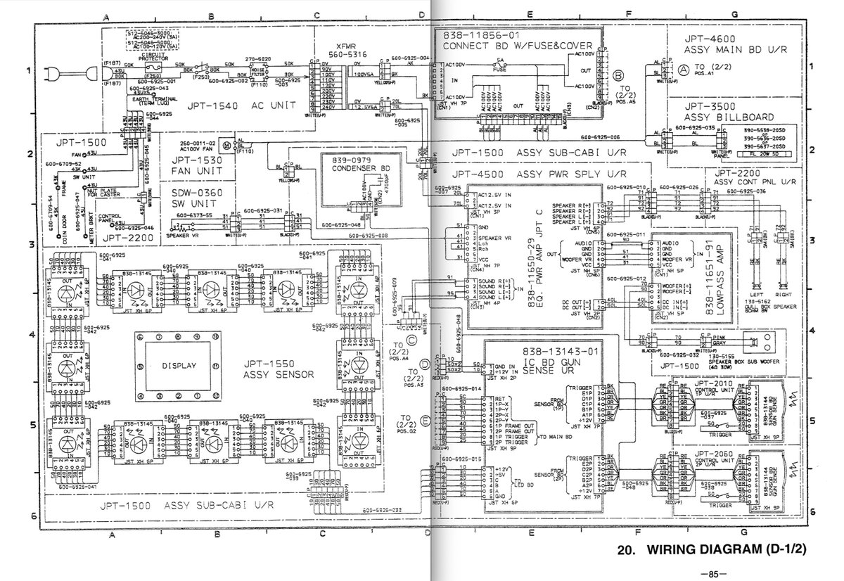

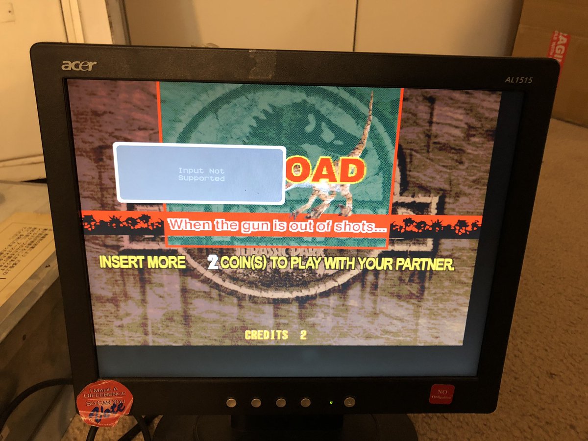

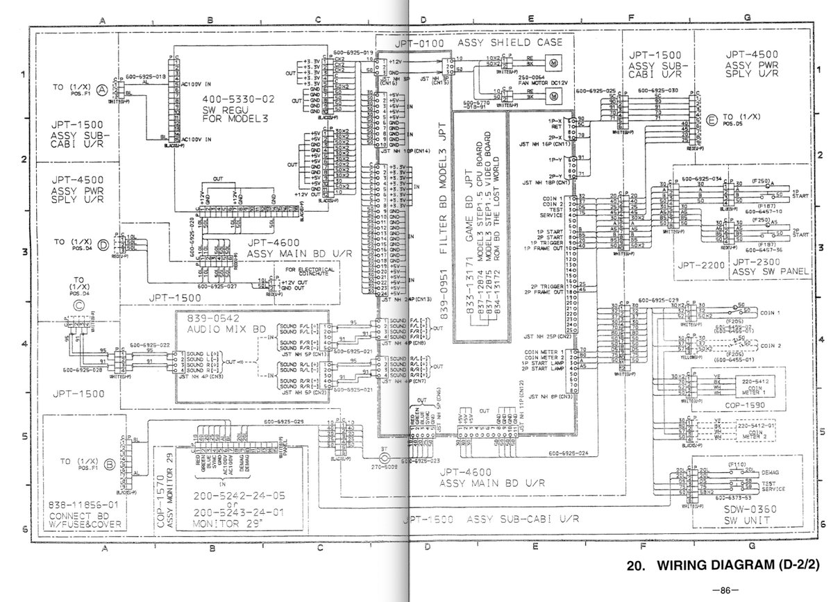

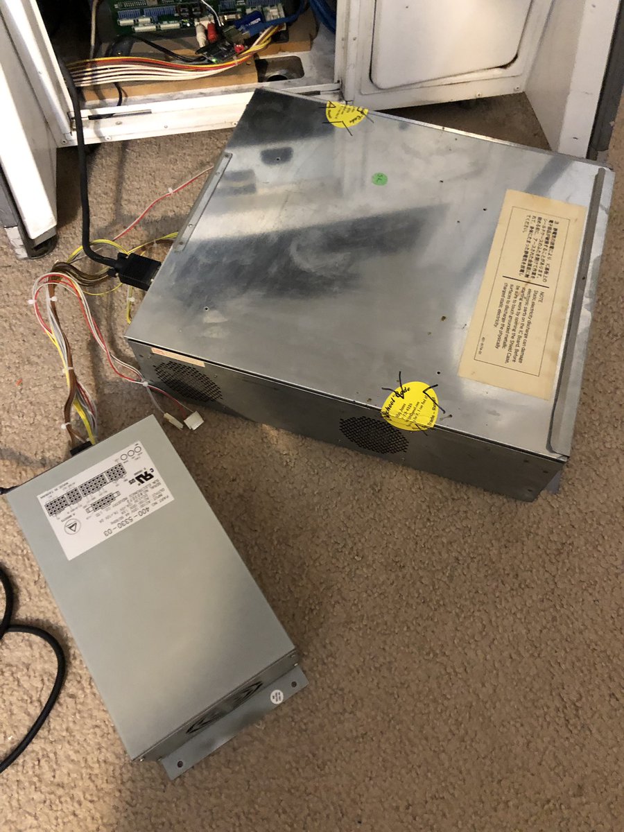

I'm catching back up on this thread to hook up a JPLW that I picked up many months ago. I finally got a power supply for it, so the beast has been awaken. If anyone is interested in connecting the Gun IO board, and LED based guns as an alternative to the analog X/Y gun, this should help.
