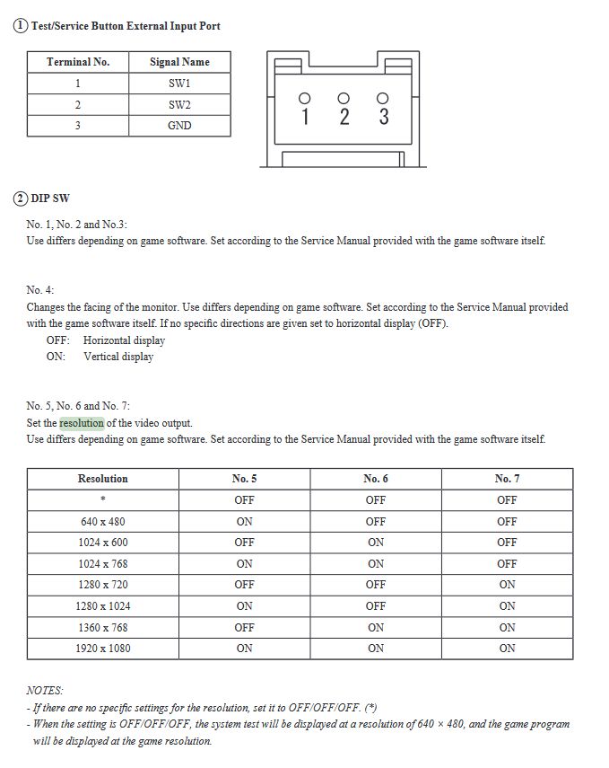

As for dip switches, the only good source for them I found was in the Virtua Tennis 4 manual. Again, not all games will support all resolutions.
Yes, avoid using the Capcom I/O ( honestly I'd avoid using it on anything as it adds lag ).

The fact is that I have set 5 ON and the rest OFF and it looks terrible, as you can see in the video above.

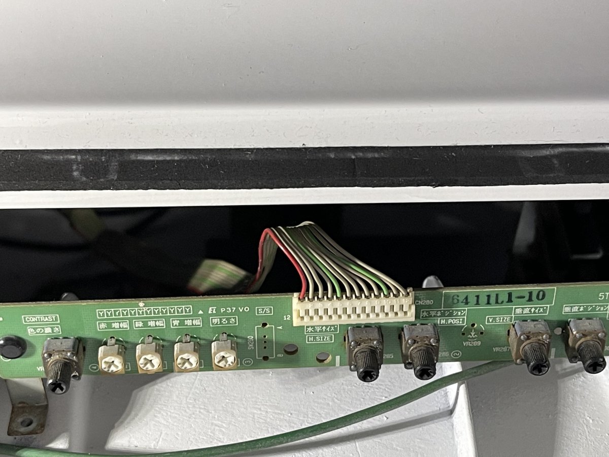

You still didn't tell me what monitor you have in your Astro City? Normally Astros have dual sync monitors. If you're not sure about your monitor, take a pic of the small adjustment board (also known as the remote).

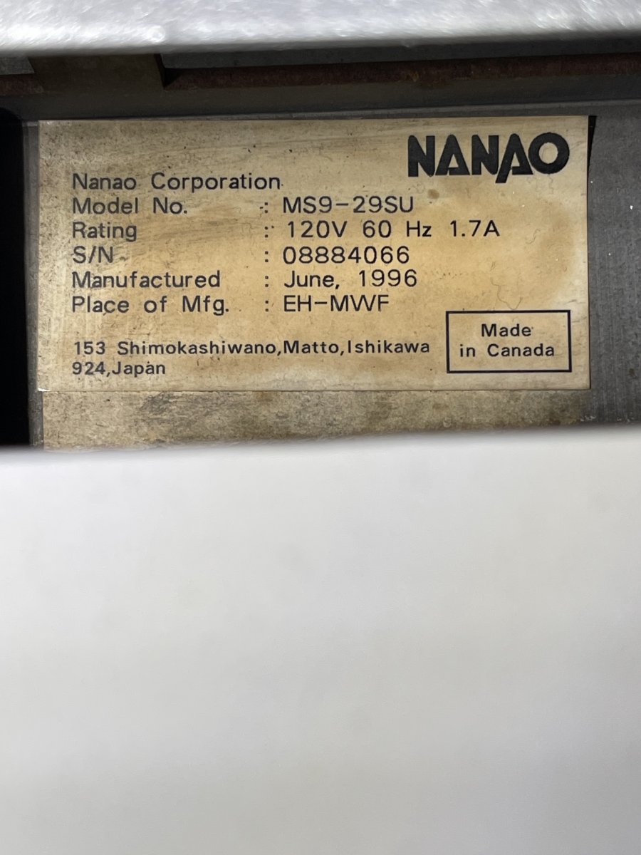

Sorry, I didn’t notice your question. I’m going to make more photos for you. Thanks again 🙂
Yeah, that's not going to work. MS9-29 is 15khz and 24khz only. RE2 outputs 31khz at minimum.
Okay, so that's all the Astro can yield. Well, now if yes, I need a blast or something more modern. Thank you all very much for the quick answers and for the help. This is a great community with people willing to help always.

Just to double check, take a pic of the chassis (or the remote), just so I can verify it's indeed the original chassis on the monitor.
Ii think, it’s the standard one. I think I will look for a blast city or newer one. 🙂👍🏻
