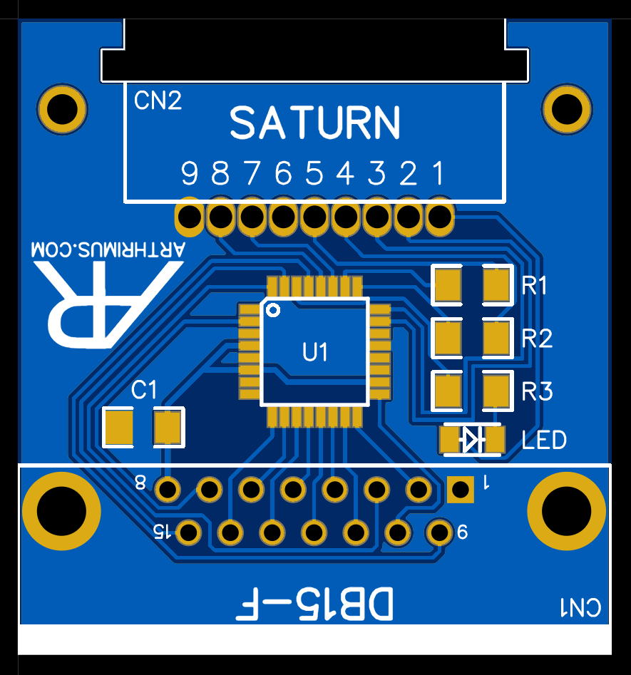

I've been enjoying these adapters so much I decided to put my own personal spin onto the PCB.
I've ditched the current limiting resistors (living on the edge man) and changed the SMD resistors and capacitors to 1206 (so I don't need to squint so much when soldering and to keep it as simple and quick to solder as possible). Ditched the programming jumper pad is it's not necessary to keep RST open. VIA free design, Tried to pay respect to your creation and made the silkscreen nice and tidy / exciting.

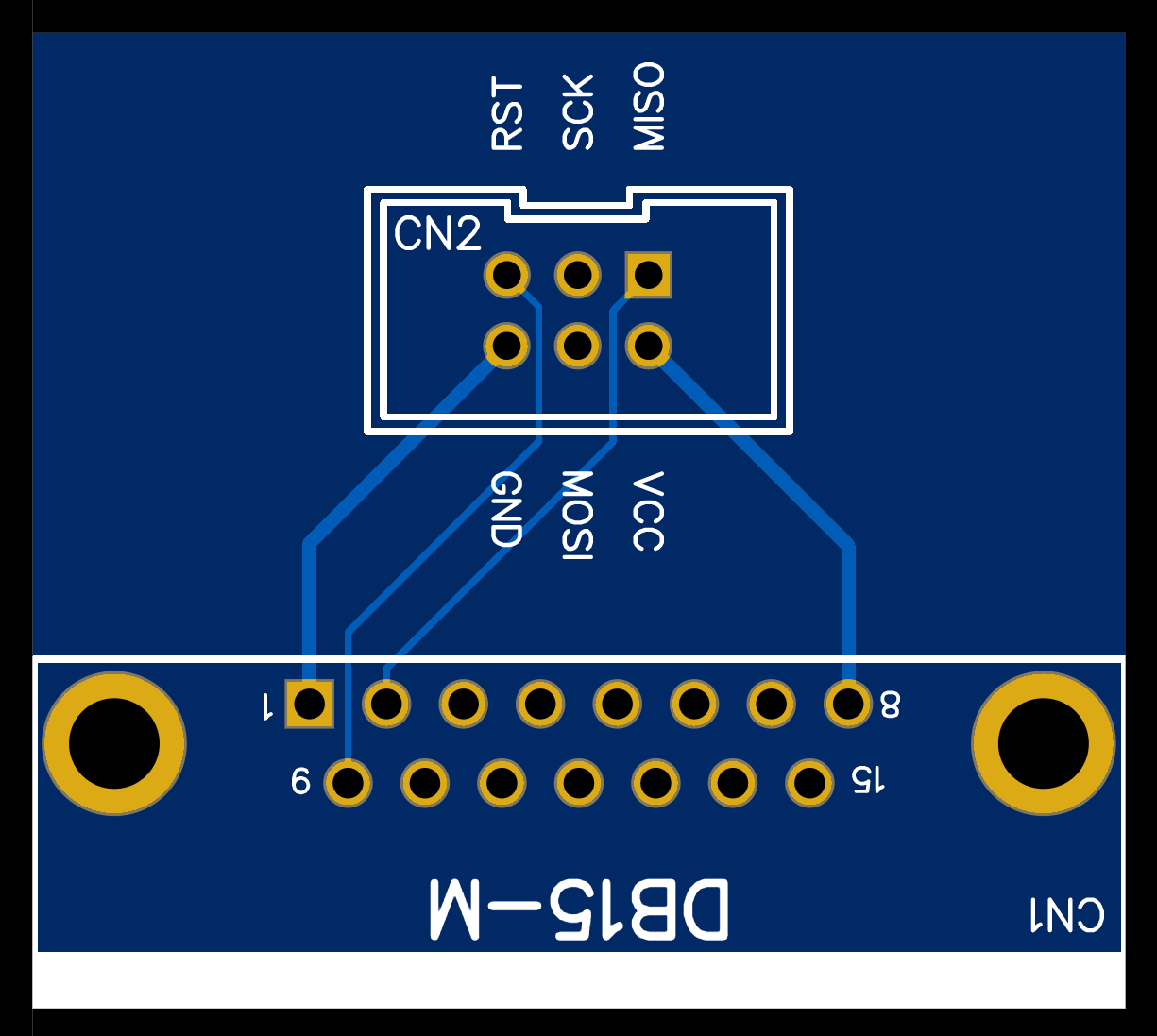

Also made a simple programming helper PCB for easy connection to a USB ISP device.
Looks great! One thing I'm adding to my adapter PCB is an LED that indicates when you are in button mapping and auto fire modes. It's going to be connected to PD0.
It will be connected to +5v then a current limiting resistor then PD0. PD0 will be driven low to turn the LED on. If you think you can fit it on your PCB that would be awesome.

That should work out well.
I can place R3 beneath R2 with the LED beneath it, so they're all lined up and asthetically pleasing.
All done. Managed to squeeze it all in and retain my zero VIA policy. :)
Just want to confirm the routing, I've done it thusly:
U1 PIN 30 (PD0) to R3 PAD 1
R3 PAD 2 to LED CATHODE
LED ANODE TO +5V
