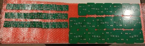

So close. Whipped one together and it all works perfectly barring the IR receiver. It works but reads a different signal for the same button press, every time that same button is pressed.
So I may just leave the IR receiver out of the SMD assembly and resort back to the through hole one.
A bit saddening the IR receiver didn't work out. I think it has a too broad frequency range, or perhaps just too sensitive. I'm receiving upwards of 8 unique codes per button press. So I'll just resort back to the through hole IR receiver. Everything else is spot on.
Also made a new S16 jamma adapter. Supports remapping of 4 buttons and added some mounting holes. Just need to correct a minor cosmetic mistake re the outline of the switch silkscreen.
