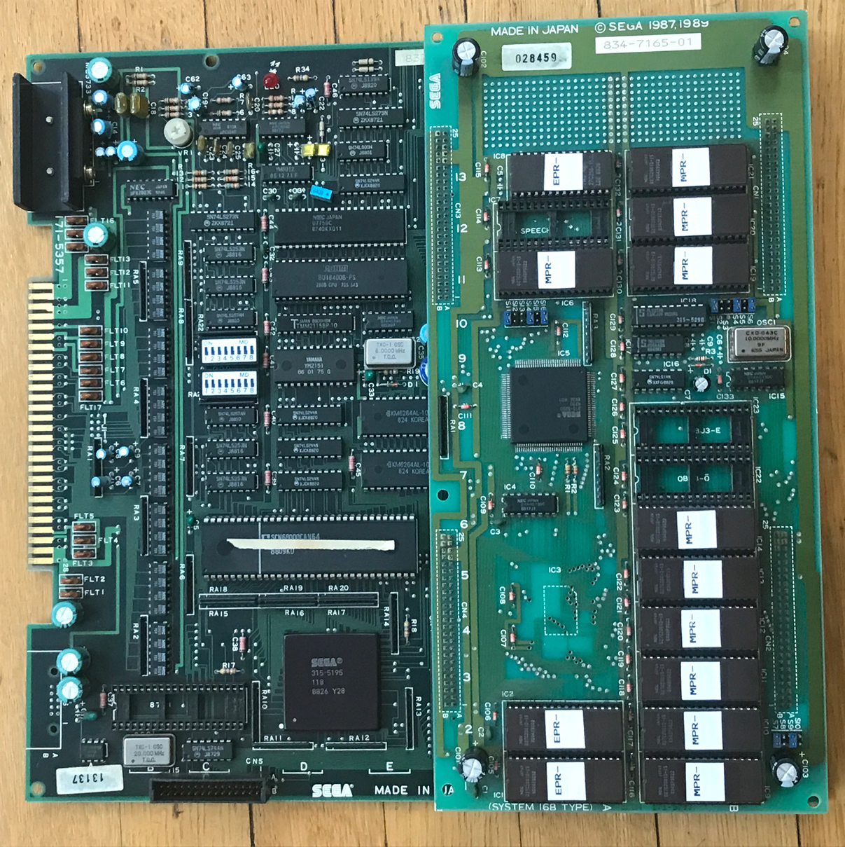

Happy new years to everyone on Arcade-Projects! I present to you another guide, this time we are going to make Golden Axe! This is probably the *easiest* System16 conversion that can be done. I intentionally started discussing System16 conversions with Golden Axe as it is very easy and users of all skill levels can jump right in!
Important: This guide is for 171-5797 rom boards ONLY. It is the System 16B rom board that has a custom Sega QFP IC marked 315-5250 (see pic!)

Remove the FD1094 Epoxy Block CPU, replace with the stock 68000 12mhz CPU. Pin 1 faces towards the edge connector. If there is an MCU installed at position C2, remove it, it is not needed.
