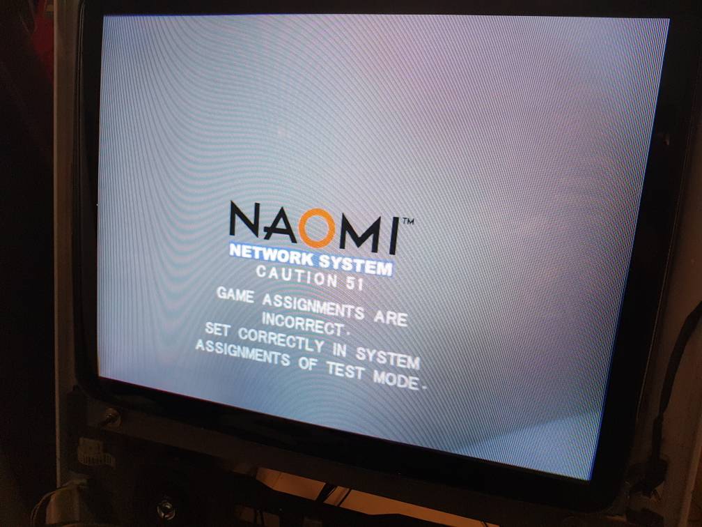

Unfortunately, I have no idea if it works properly as I've tried two different Naomi boards and I still get the same as error.
I believe my bios is way out of date and that it's not even compatible with the net dimm! (I've got EPR-D 21580)
I'm hoping the multi bios comes in my possession sometime early next week to give the net boot a good test! Fingers crossed that the net dimm works as expected.

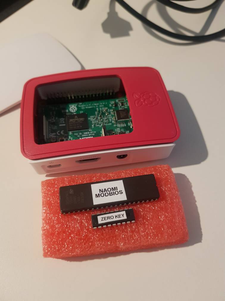

So I got delivery of the final pieces to the puzzle today!
A raspberry pi 3 and the Multibios and zero key! (thanks @oneleaf86!!)

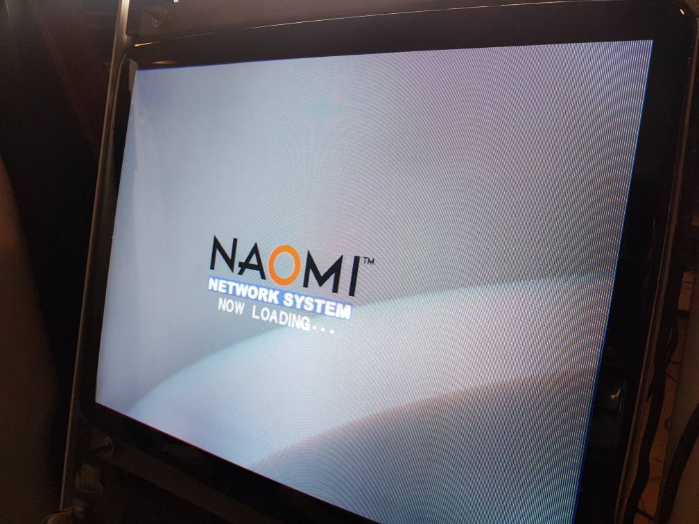

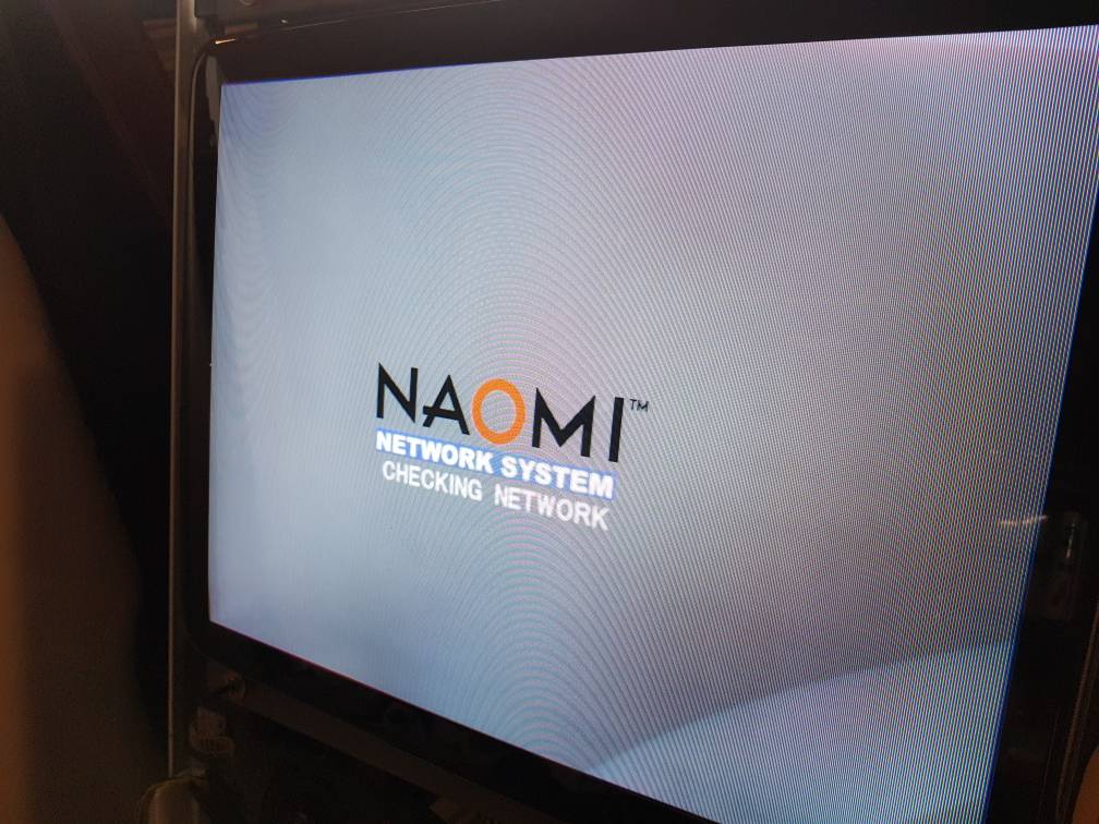

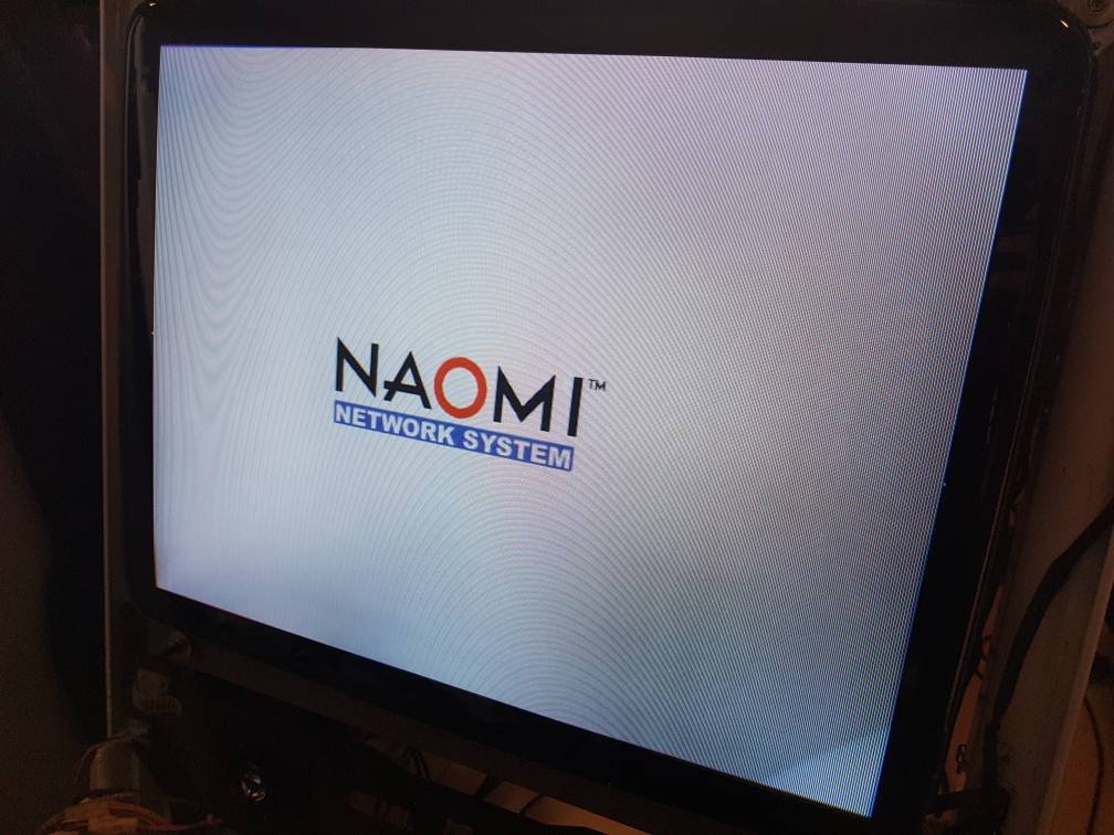

After changing the bios, the error 01 code immediately disappeared and got the network system splash screen - very good sign!

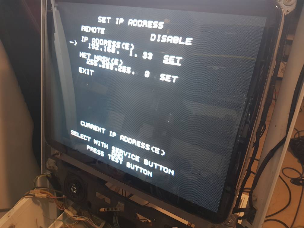

Took me about 5 minutes to figure out after "setting" the IP address, I needed to reboot the system for me to successfully ping the device from my computer.

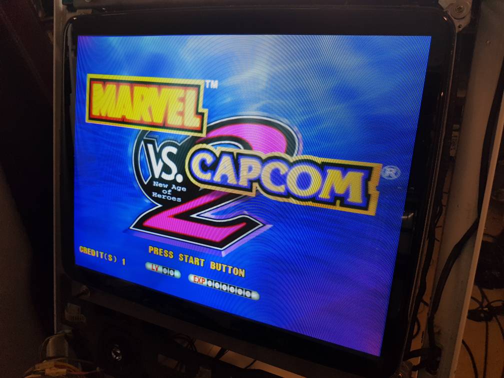

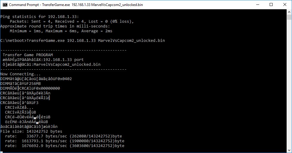

Did a transfer of mvc2 as a quick test..
The following screens started appearing
Unfortunately upon loading, I got this screen

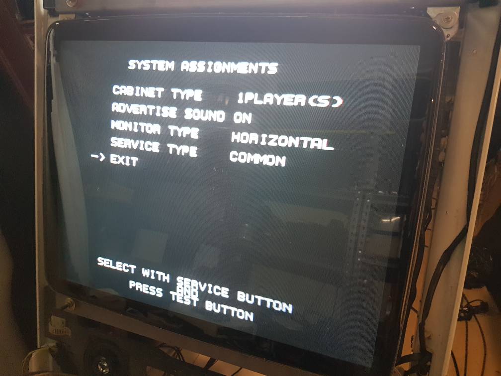

Took me another 5 or so mins to figure out that I needed to change the machine type from 1 player to 2 player.
Once that setting was changed....
Voila!!

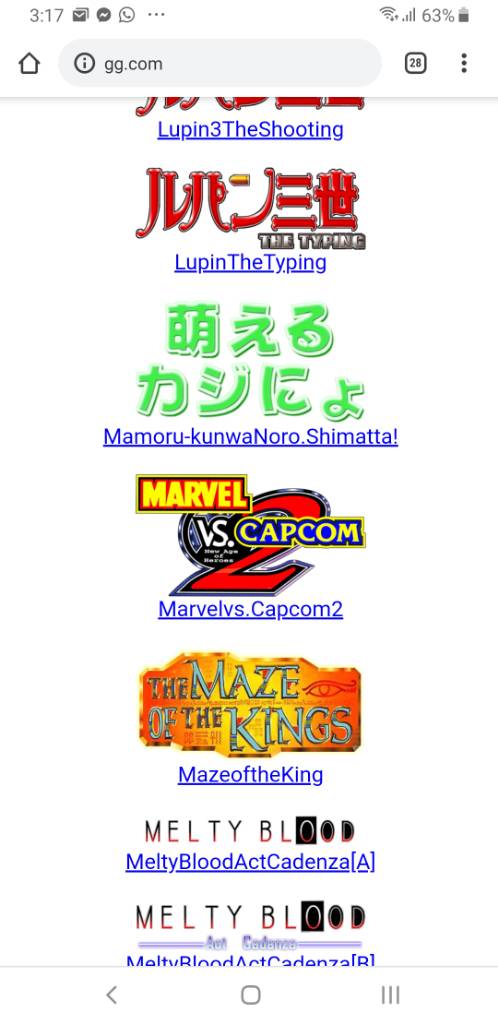

Next to fix and properly test the raspberry pi loader via a Web browser (either from my phone, tablet or anything)

In light of issue that occurred, on a good note, I fixed the my piforce issue I was having - no idea how, but loading bins is now possible on a web browser!
