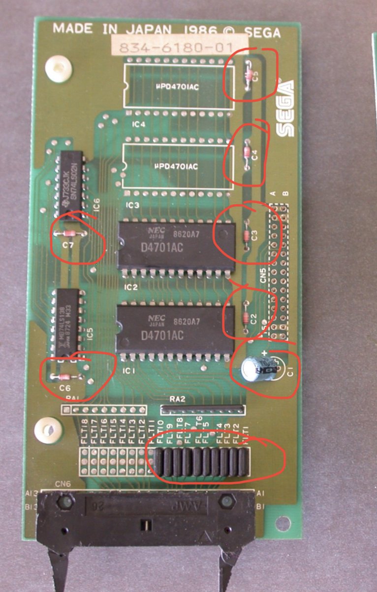

Very nice, does anybody know what are those
The capacitor looks 100uf16v, the resistors I’m not sure looks red red orange & silver and the black ones have no idea.
just want conform, much appreciated.
Hi AGC,
What you call resistors are decoupling capacitors, hence the name c2, c3, c4,... you can put the classic 104n ceramic ones.
the black FTLs are antiparasitic filters, you can take them from a donor pcb or just make a jumper between the 2 ends of the ftl in the circuit.
Greetings!

I’m ordering now the minimum order just for testing.
Will take a little bit until the parts arrives, assembled and test.
I’ll keep posting the results
