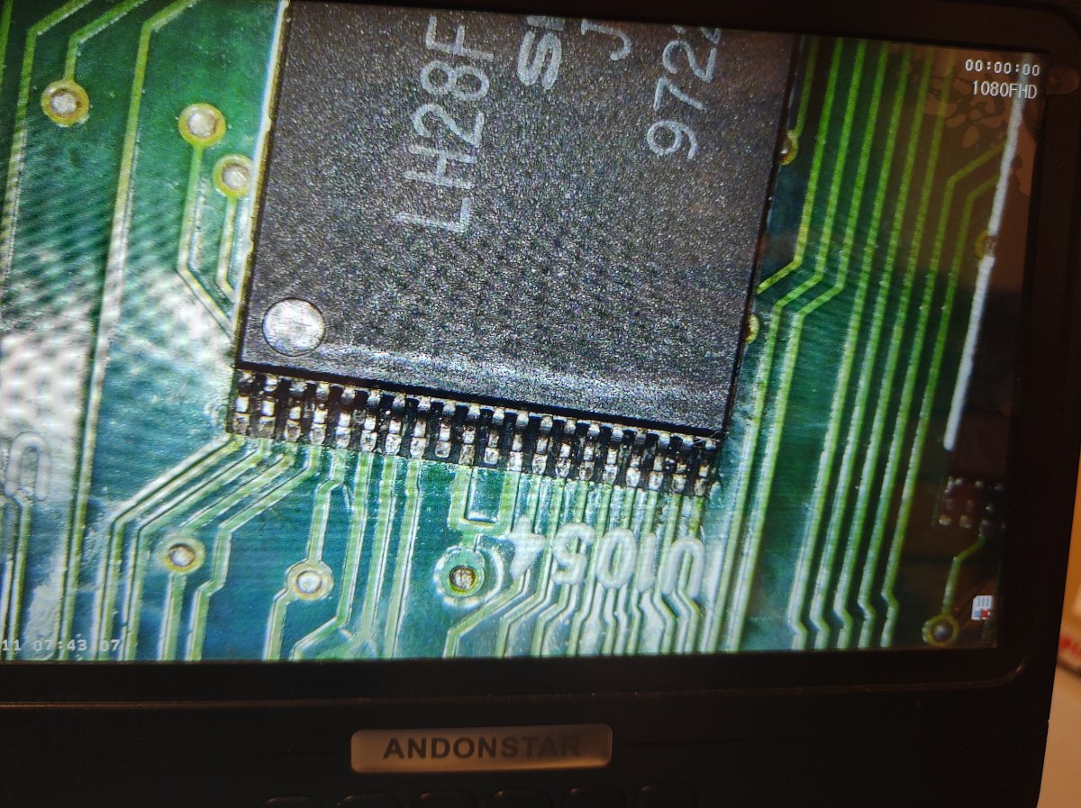

Hi there,
i have a Raiden fighter 1 and i have a weird sound issue, seems to miss part of the sounds, music is not normal, not scratchy or what, but like missing on voice canal.
Other sound like explosion or shoot are ok.
I've tried to move the jumper (D board) and searched for cutted trace or cold solder on the Yamaha, but nothing.
If someone could have a clue.
Thanks.

@Brakvader Based on the videos you sent me of the game it running, it sounds like you are missing some audio channels that are generated from the Yamaha chip. As @Big_P Big_p suggested a reflow of the QFP chips on the mainboard, even if they look ok at first glance, tends to fix a lot of issues. Drag soldering is worth a shot with a very fine tip.
Ok thanks, will try that, i had another with no sound at all, and was the Yamaha with a Moving leg, but in this case, i didn't saw anything with the microscope and try to Moving legs....Hope a reflow could help.
